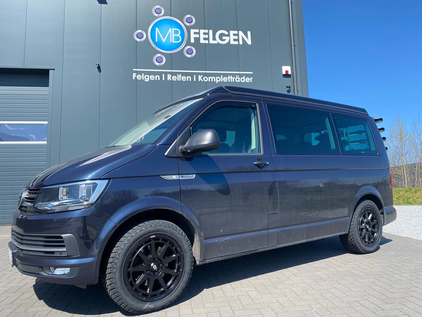

Tyres…think I’m settled on the Grabber AT3s but am still unsure whether to get a 235/55R17 103H or a 235/65R17 108V. Stock seems limited in most places on the 235/55 so I’m wondering if they’re phasing that out which puts me off a bit…final call, will I DEFINITELY not have any issues running a 235/65R17 on stock suspension and with active TPMS? Don’t want to get this wrong.

235/65r17 KO2’s ran for 6k miles. No issues.
No tPMS , but tpms, only shows pressure inside the tyre.
If it was going to affect anything it would be ABS for the axle turning.
But they still turn nicely on the French autobahn !!

active TPMS no issue for either dimension, will work the same.
as for the size, check the diff below: Screenshot 2024-01-27 at 16.28.49.png

strictly for me, being probably sort of stickler person (not sure if right english term), as you also appear to be, I would go for 235/55/R17 103H, as I will otherwise constantly worry on wheel clearance with a NON-raised suspension van, and also the load and speed index, 103H, will be exactly the same recommended by the manufacturer, meaning the sidewall rigidness is correct and not stiffer as for 108V.

Stickler’s the right term and I think I agree with you :) I may just check they’re still in production though as it’d be annoying if I had to change one before the others
