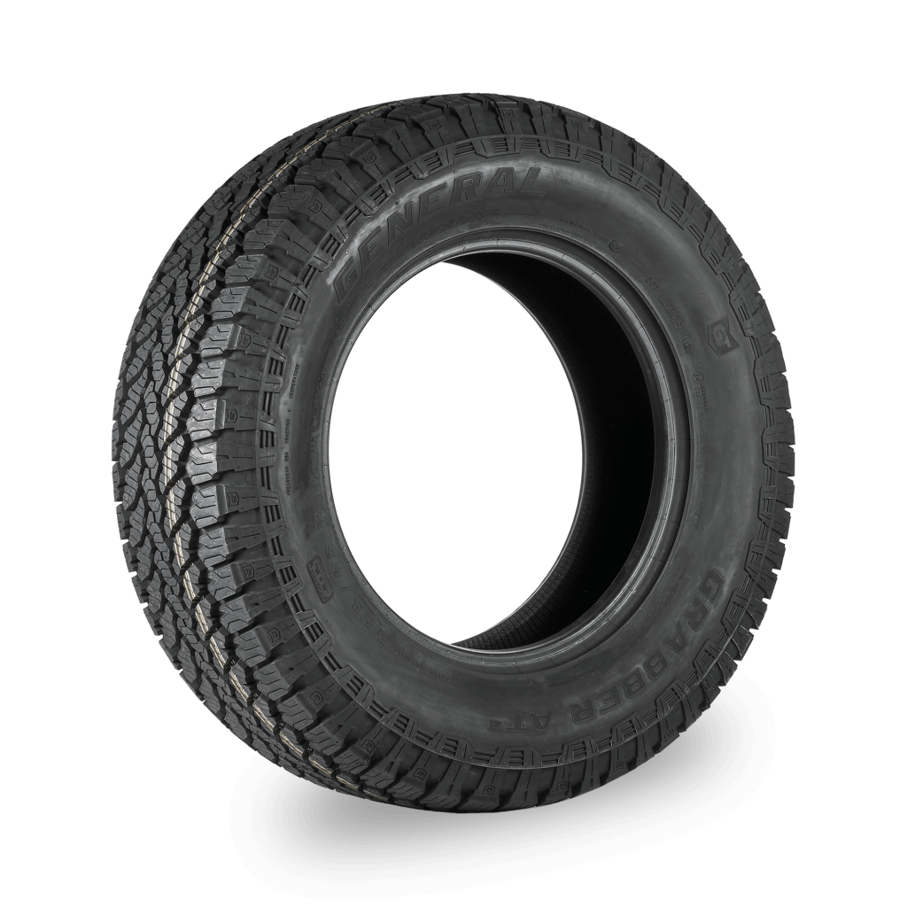

General do a Grabber AT3 in 235/55R17, it's about the only all-terrain tyre I've seen in one of the preset sizes listed on my Discover Pro system, the rest in that size appear to be all-seasons like the Michelin Cross Climates.
If I go for AT rather than all-seasons that's probably where I'll land, can't shake the feeling of wanting to play it safe and stick to the presets to avoid any issues.
