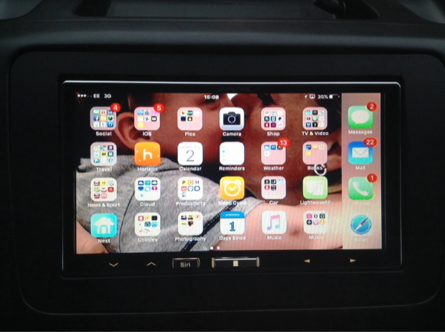

That's it. Once done, your phone should then be mirrored onto the head unit. Rotate the screen to landscape and lock it to stop it flipping around.
You should see the home screen rotated if you're using a supported (later) iPhone (fuzzy images alert!)

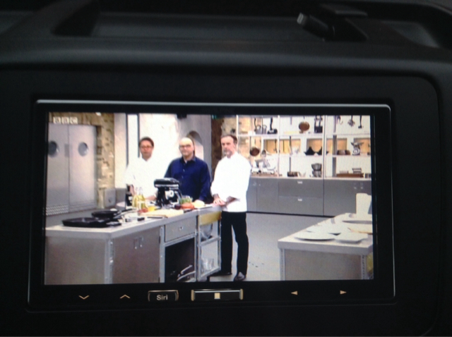

Most (but not all) video apps will display (youtube doesn't, many subscription services doesnt). You may be able to cast youtube videos onto the airplay display from within the youtube app, but I've not tried this yet. iPlayer works well.

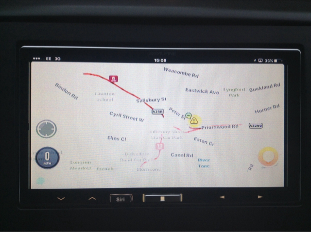

More importantly all Nav products will display, so you can show CoPilot, TomTom or NavMii etc
