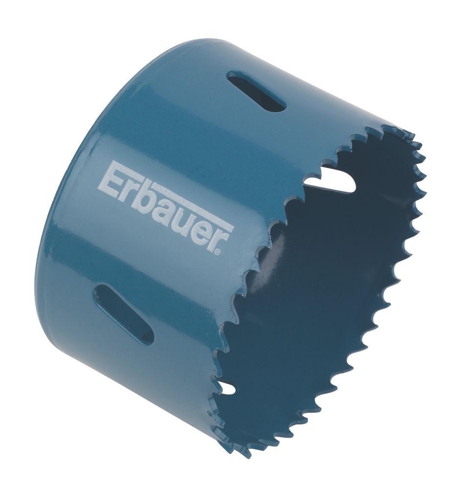

If you don't mind cutting a big hole in a piece of plastic I've fitted a few in the plastic pillar cover that is above the fridge/worktop. It pulls off, then you can cut a hole with a hole saw and mount it in the middle. A lot easiert than it sounds, though running the cable behind the worktop can be fiddly.

You've got a fair bit of scope to dremel without the edges being visible but the above makes it a 2 minute job. I do use it a lot mind you! :)
ah yes, i see now it's a round hole - even better! Thanks!
