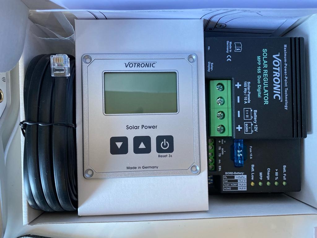

so - update! All done, fitted and working fantastically! All in all, it was a fun and reasonably straightforward process. You need to be a bit handy though for the 'full' dual battery set-up with remote control panel and connecting the front battery via the left front seat. (connecting the wire under the seat was a bit of job i found, because with the LHD car i couldn't easily lift and rest the seat on the dash.)
Anyway both sets of batteries after a few days (of very little direct sun) have gone from reading 12.2V to reading 12.9+ so i'm happy. Check it out:

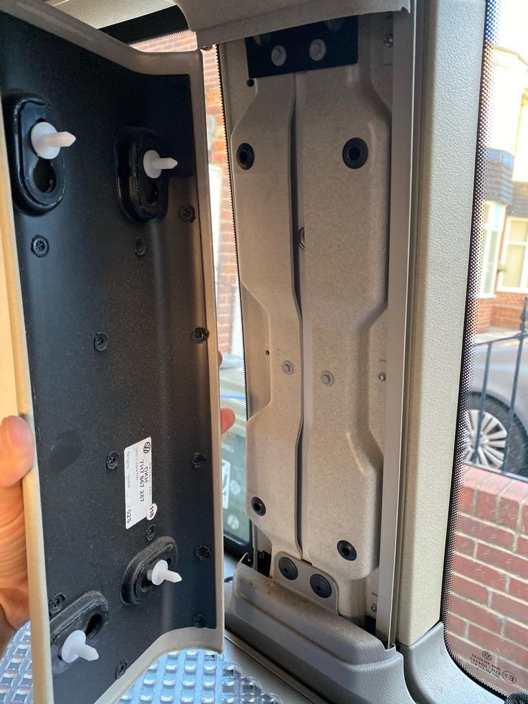

I’m going to install a display panel on the pillar the same way. How does it come off it feels a bit tight I’m afraid to break a grommet or something. From your photos it looks like there’s at least two on the bottom, do you just need to pull hard and hope for the best?
The C pillar cover is held with 4x plastic press studs....2x top + 2x bottom. Just be steady and it will come free. Use plastic trim tool to help remove.
Thanks

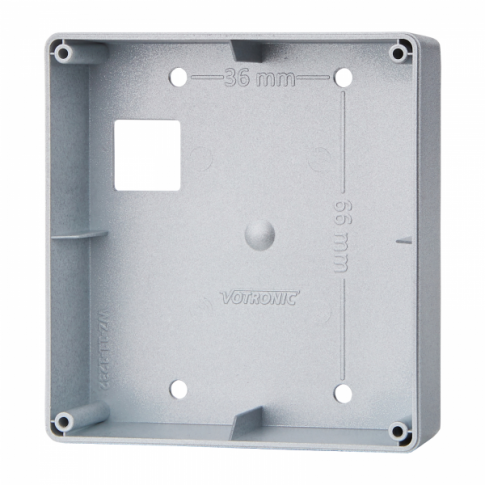

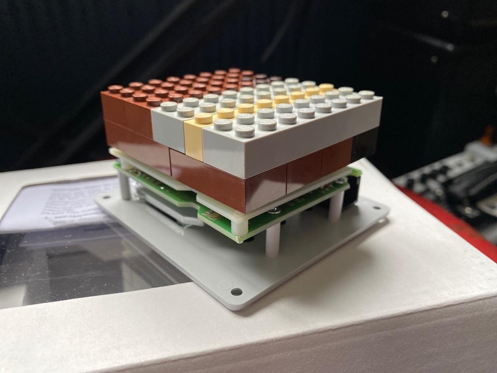

There isn’t as much space behind it as I expected. I ordered the Voltronic kit along with Richard’s panel kit so I’ll update when I get it done. The panel seems slimmer if anything.
Here is a photo which hopefully helps the next person so you know exactly where all the studs are!
I cut the hole around here:

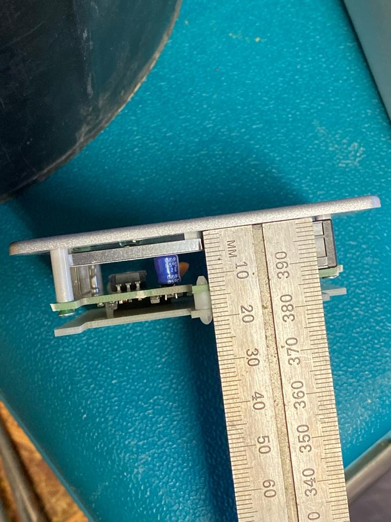

So that it matches the indent behind. For reference, the MT50 and MT11 depth behind the panel is: 12mm. PLUS the network cable plug sticking out the back of it. The pillar clips back on happily with that installed.
So although the Votronic display panel sits very flush, it requires an extra cm of depth at nearly 22mm including the little pins
The panel is probably only a couple millimetres thick, so just see if this is going to fit I may have to fashion a little block of wood or something with the same dimensions so I don’t have to damage the panel to try it out. Will just see if I can push the panel back in with something 20mm thick behind it
Good idea that. Shame They make the back square. Round means an easy hole cut.
The circuitboard is nearly exactly the size of a 8x9x2 Lego. I managed to push the panel back on, barely, with the Lego brick behind

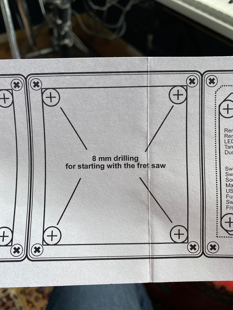

Not as easy as a round install but they provide a drilling template
Looks like a standard square electrical adapter will do to lift the panel away from the plastic.
You'll get this at screwfix or similar.
I’ll have a look. Votronic makes one, but charges £20 for it and I may just need a few mm lift to make it a little less snug. Rather not have it protruding out at that rate I’ll put it somewhere else like above the vanity door
I've just had a look.
Screwfix do not have anything.
I suggest going to a very good electrical trade store with your plate and seek guidance on what will fit.
Yes that will work for you but will require you to cut in to the nice aluminium cabinet.
When I fitted the MT11 Epever remote panel in to the C pillar cover, I took a view that I could always buy a new plastic trim cover.
As Roger has said it only required a round hole and came supplied with the surround adapter plate.
Cutting in to the aluminium cabinet is somewhat permanent.
