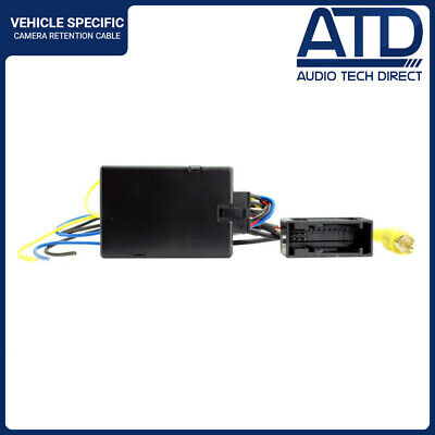

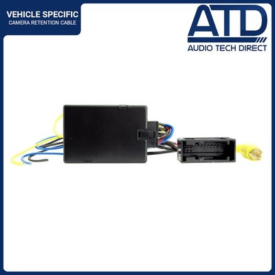

I’ve just bought a RCD330 from an eBay seller with included adapters for the aerial and reversing camera. It was to replace a factory fit RNS510 with reversing camera in our T5.
Sadly the aerial adapter lead didn’t fit properly but works ok.
The big issue is the RVC lead with an RCA plug didn’t match the 26 pin plug in the factory fit loom :(
Has anyone found an adapter for the factory fit camera plug so it can plug into the RCD 330?
I’m waiting to hear back from the eBay seller but thought it worth asking here.
I think I may have found what I need. The RCD330 appears to have leads made to accept an RCA feed and there’s an adapter to convert the OEM camera feed to an RCA output.
This doesn’t seem logical to me but I’ve still not found an OEM camera lead to RCD blueplug adapter....

Found a few different adapters. Appears that to get a camera signal into the RCD330 you need to use the RCA lead. So the 26pun plug that goes into the RNS510 has to be converted to RCA.
Bought one these:
