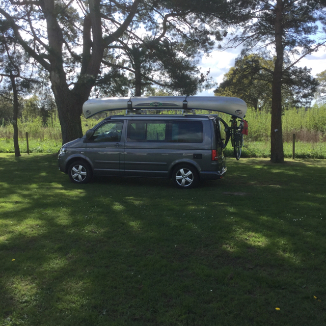

I've searched the forum and have formed the following assumptions. Has anybody else had the very same research to do and decisions to make?
1. I want to carry a Linder Inkas 465L open canoe: 4.65m long, 0.85m wide, 28kg. I want assisted lift. My only option is a Karitek as my canoe is too big for a Thule Hullavator. True or False.
2. If I want to carry two bikes at the same time as my canoe, I will have to get a ball hitch fitted and use a ball hitch mounted Atera bike rack as VW, Thule or Fiamma tailgate bike racks will carry the bikes too high when also carrying a canoe. True or False.
Any tips or advice would be appreciated.

I have a Karitek rack. It is very good, albeit a bit commercial looking. I can load my 16' Canadian on my own, unless it's windy when I wouldn't risk it. You are correct in saying that you couldn't carry bikes on the vw rack at the same time as a canoe.

How long is your canoe, do you plan to carry it upwards/downwards and how much slope is there to the decks?
Ours is 4.6m and quite heavy, we couldn't carry it with the VW bike rack as this rack holds the bikes too high.
In the end we went with a Karitek assisted lift canoe rack, we are not getting younger and it's too heavy to lift straight on. We carry it bottom upwards so that it doesn't fill with rain. The decks slope down over the ends of the vehicle and barely miss the wing mirror when loading. If younger and fitter, maybe consider roof bars with a roller.
The bike rack is a 2-bike Thule Raceway which you can position on the tailgate to suit. Care is needed to avoid using the rear wiper. A ball hitch bike rack might have been a better solution, but I don't have a tow bar, so for reasons of cost thought I would give the Thule a go.
In this picture, the bike rack is high to allow the rear wiper to operate and to see the number plate. I am going to mount it lower for convenience when loading bike. I'll also try shifting the canoe further forward on the rack to try and create more space between the canoe and wing mirror. The picture shows my first attempt.

There have been posts on here where people have adapted the VW tailgate cycle carrier to hold the bikes with the front wheel removed. This drops the height of the bikes to below roof level. Might still not be enough clearance loading the canoe hull side up though.
I can carry a kayak + bikes on a tailgate rack (Atera Linea). But I load the boat hull side down to get the clearance needed. Posted a video a while ago on the system I use to load the boat but not sure it would work for a larger canoe.
