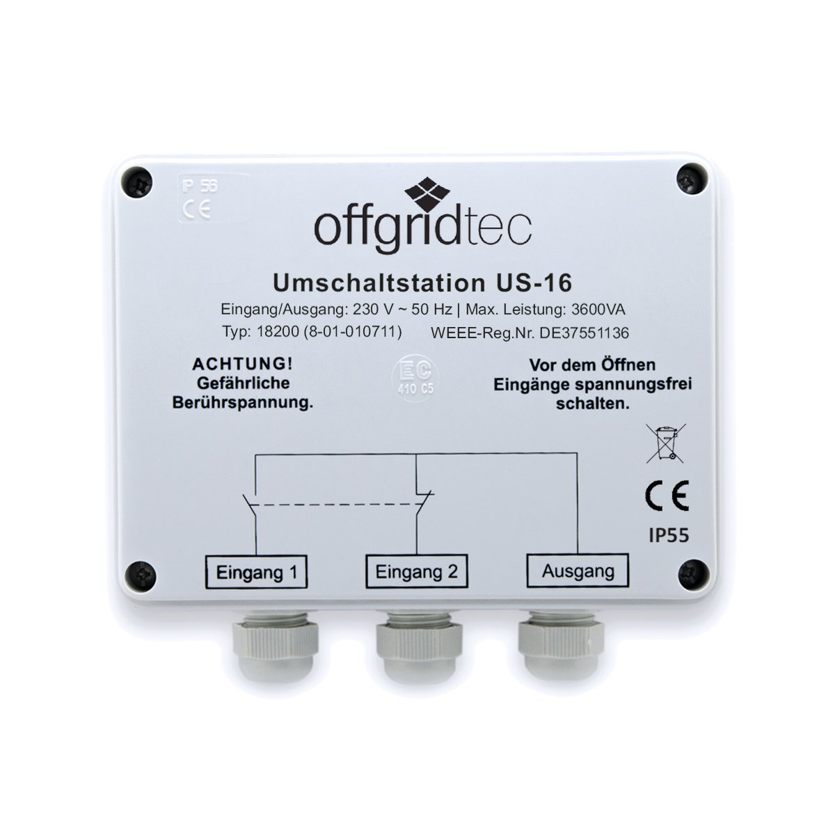

Like some others I intend to fit a manual changeover switch beside the consumer unit in the cupboard, intercept the incoming wago plug to the CU from the EHU and wire from one of the 13A sockets on the delta 2 to the changeover switch taking both into the changeover switch and then refeeding the CU. In theory this should enable me to (safely) inject 230v from the delta 2 to feed the CU without back feeding the EHU inlet and, if I am correct will not only charge the leisure battery but make the internal sockets live off grid.

Not sure if this is any use, it’s an auto transfer switch, it gives priority to EHU but switches automatically to battery/ supply 2 if no EHU power is present. I used one in our setup.

I have a Ef Delta and have been looking at this changeover switch.
Seems simple enough. Although I will get a qualified sparky to test out that the rcd still functions whilst on delta power.

If I was going to use the app to control power from the delta I see no point in an electronic relay. U would just leave the manual changeover switch set to delta unless on a hook up

Testing is prudent but the RCD isn’t going to distinguish between 230v from EHU or delta and as long as it disconnects for either it’s safe for both
