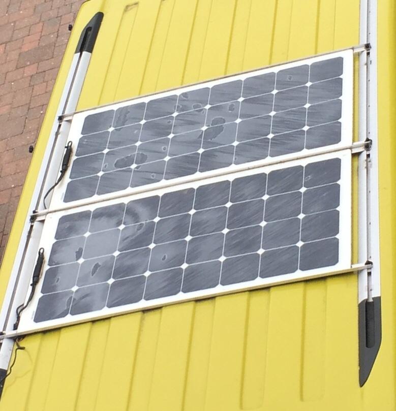

5 yr old panel. Vehicle garaged outside all year round.
A very significant difference. It almost looks like my solar panels aren’t designed to be left lying around in sunlight!

@Amarillo, do your panels still give you enough current in this condition?
I’ve never been completely satisfied with the current in direct sunlight. But now there’s something seriously wrong. Now showing 15 volts and zero amps and the battery at 2 out of 5 bars. I need to go back to Roger and probably buy two new panels.
I think we both got the panels from the same supplier. Mines a 100w panel, I'm not sure about Tom's. Could be different manufacturers.

Here’s a photo of my three year old panels.
Hi Tom
These are the same as my panels from Roger and exactly the same thing has happened to mine, after 3 years. May I ask what you did please? Roger has offered me 2 new ones at a discount but my confidence has been knocked in the product. I guess we both paid the same but I'm loathe to fork out substantial amounts every few years. I think WG bought his just before us and it seems he was lucky to get a better manufacturer.

Thanks Tom. I think you'll be surprised at the cost of replacement panels and you are correct Roger no longer deals with this manufacturer. I think we were unlucky in getting a poor quality panel which doesn't have a long lifespan. Hopefully any replacement will be better.
The panels I use has been a learning process over the years - mostly down to improvements in manufacturing techniques.
With thin panels:
At the start, all that was available were fairly rigid aluminium backed panels with a silver-ish backcround and a PET (same as drink bottle plastic) covering. The plastic seems to cloud over after a handful of years but they still function, at a less efficient rate. The PET also peels off on most of them over time
I then moved on to pure plastic panels - often back-contact panels as this reduced weight, and was supposed to be the next big upgrade. These are the panels in Amarillos photos - his are 4 years old and have some apparent bubbles in the PET coating.
Next I moved to what was supposed to be the next big thing - ARFLX panels - a rigid aluminium core, then coated front and back in EFTE plastic (doesn't delaminate and blister like PET). The idea with those was that they rigidity would make them more robust. The reality is they have not been much of an upgrade. I think the mix of materials means they expand and contract at different speeds internally when the temperature changes.
Finally(!) I had been buying Dual-EFTE panels form a UK supplier - these are basically solar cells totally encapsulated in EFTE plastic. I know from experience EFTE does not (so far!) cloud, nor does it blister. There are no stuck on layers to delaminate like with PET. They are layered up then melted into one complete unit. All layers gone. They are also failry rigid in comparison to plastic solar panels - a feature I want because I don't want them flexing repeatedly, or vibrating. That causes internal mechanical failures on softer panels, I'm sure. I have had very few failures with these over the years, and then a year ago the manufacturer in China cold called me, and now.. they make them for me direct. They are the best I know of so far in terms of build quality. I had very very few failures when buying them UK sourced, and since buying them direct, around a year now, I've not has a single issue, so fingeres crossed!
