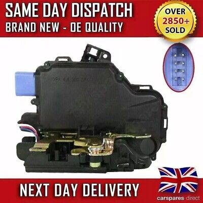

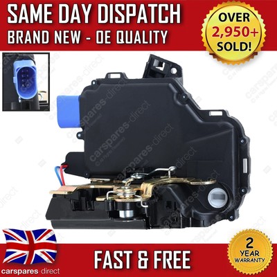

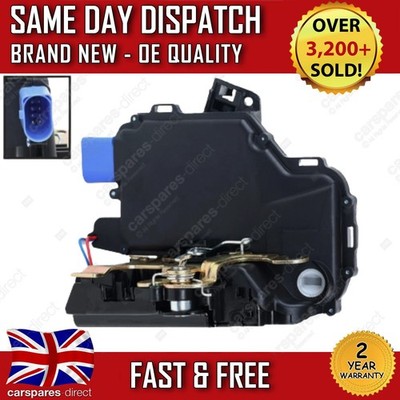

Does this give you the info you need?
Edit: I'll stand down. Looks like you have a better option above from @B J G
Thankyou from me as well, I have a 2006 2.5 with a similar problem, my drivers door lock doesnt always lock with the remote, its fine with the key, but sometimes locks on remote and sometimes doesnt. I have just ordered an actuator from ebay as well which hopefully will solve the problem.
