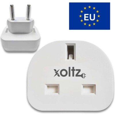

Do you know where you can get an adapter, the two pin in the unusual shape to a conventional 3 pin?

In any case I wired myself a lead about 1mtr long which has the euro 2 pin plug on one end and a trailing uk socket on the other. I’ve put some Velcro on the back of the socket, and some on the side of the kitchen, and also on the metal in the pop top which means it can be stuck on either of those locations depending on where I need power. Will only use it for charging a phone or iPad but it’s handy to be able to move it around the van so it can be used anywhere.
Euro plug example - https://www.amazon.co.uk/gp/aw/d/B0CXQ4V7PK?tag=unique09f-21
Trailing socket example - https://www.amazon.co.uk/Masterplug...iling-without/dp/B07L8N2TC1/?tag=unique09f-21
Trailing socket example - https://www.amazon.co.uk/Masterplug-ELS13W-01-Single-Trailing-without/dp/B07L8N2TC1/ref=mp_s_a_1_8?crid=1QZI8X5S1YM41&dib=eyJ2IjoiMSJ9.zFmohg_vKk0Xc4gtcplPfgE2E_Vfa0yVnADZjWuyC9dac5x7G5ZnfLBU_5BTt4IB6P_rGl3ANuh_QD1YDH9xDqEMpo5FE_Qxh14HwfcUsaNdAsuqFWyvjgHMA0sNaZoHwySEhYdiIfPDNYWUdFXNZZ8elZMpNgBp3OAvcJW-PRRO6AnPvX5wpH4v6q0Hzx8e2ue1AKqwEkoyUdAddvGRIQ.WNF_0UtDMmzW-rVCjRLOflkZj-n8FaMkwlcp7qH7Y-I&dib_tag=se&keywords=trailing+socket&qid=1748277345&sprefix=trailing+socket,aps,107&sr=8-8
