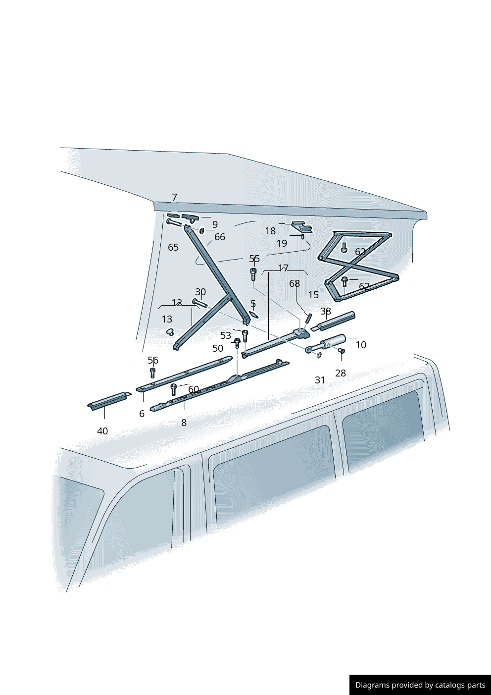

T6.1 Ocean, Since my van has had the bellows replaced, it has developed a clunk or cracking noise when I raise the roof. Only one clunky when the roof first lifts away from the van. Sounds like it's coming from the back, near side.

Make sure the bodywork where the elevating roof seal sits is clean and waxed so the seal doesn’t stick. Make sure the rubber stops/pads are still in place. All bolts tight etc.

Thanks, will take a look. I noticed the part 5 is on the driver's side but not on the near side. I'll see if I can feel where it's coming from, we are away for 2 weeks, moving most nights, so will see how it goes.
You need the part 5. It's a plastic clip that stops metal hitting metal when opening/closing the roof.
It's a very small part and won't cost you much. Easy to install yourself too, so no need for an appointment. Just go to the parts shop of any VW garage and buy it there.

Investing it, I put a couple of layers of rattle tape in place of the plastic bit (5). When I closed the top it sat up at the front end. When opened, the tape had a cut in it. Long story short, the grey plastic bit on the poptop hooks under the metal stay (the part 5 stops rattles as it's on the edge that goes past the grey bit). The reason the poptop was sitting up, is the broken clip was wedged under the roof hinge. The grey hook part on the roof was too far forward, it looks like it hit part 5 and broke it. The clunk on opening was when it came past the stay. I have moved the grey hook back around 1mm and all seems ok.

Yes thanks, seems ok, no clunks on opening and shutting ok, was worried yesterday as just started the NC500. You can see the scrapes on the roof grey hook part from the roof mechanism. It might have been that part stopping the roof closing as well. I only moved it about 1mm. Will talk to Peterborough VW when it goes back in for it's post 9/11 bellows.

Should be 7H7 067 071.
Easy to install yourself, but first you'd better adjust the hook on the roof before installing the end piece.
