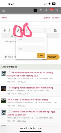

It's a Brandrup product, available from Campervantastic in the UK.
https:///_product_image_poplayer.php?ProductID=727&current_pic=2d871402de_241.jpg
Not sure why but the 2nd link doesn't appear to have copied over properly either!
