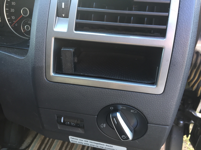

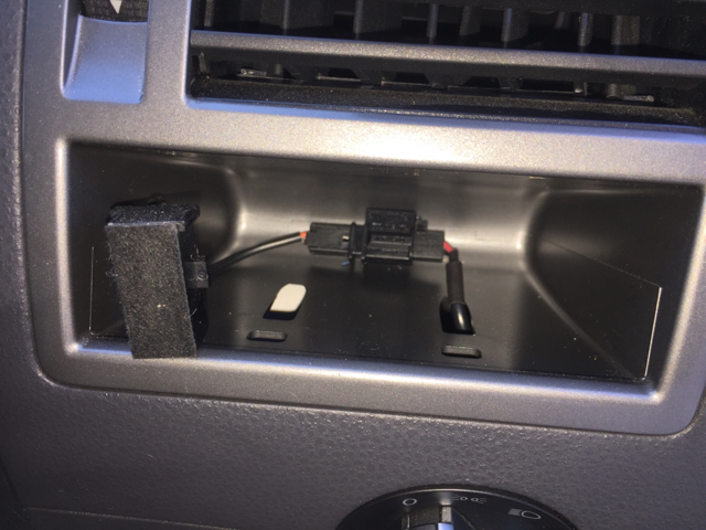

My mic currently resides in the driver side (uk) in the little coin tray until I can route it to the headlining with a mic fitting. I don't really want to cut the headlining.

Thanks for all the help Matt. I've got a brand new RNS315 on the way and a microphone to fit. I might adopt a simple install like yours for the mic in the first instance. You don't get much for £21 with that microphone bracket! where on the drivers side did you exit the mic and cable?
Not very tidy but good place for sound quality.

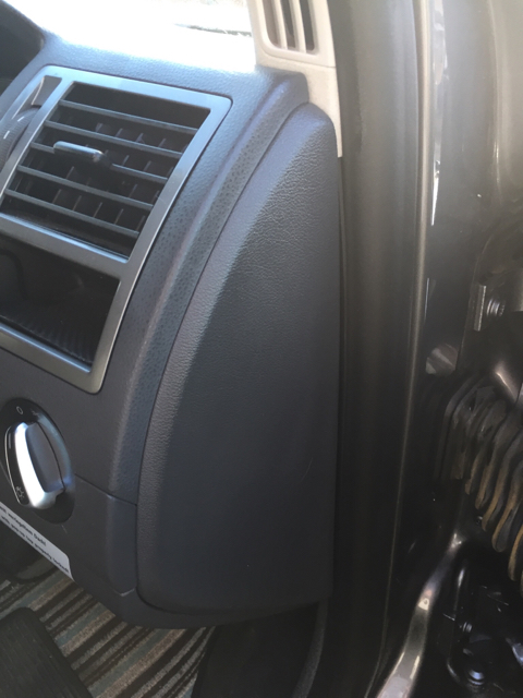

Remove this with a panel tool very easy
The rubber matt is just pressed in and has handy holes for a temporary placement
