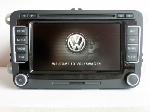

Good evening
I have a 2015 California. Had to park the van and SORN it in a climate controlled garage for a year. Sat Nav worked fine at the time. Batteries were disconnected at the start of SORN period, then reconnected when I picked up the van again 14 months later. It looks like everything works fine, except for the RNS510 Sat Nav system (and therefore the audio system).
It looks like the system is trying to boot up, but the VW Logo screen is usually split (bottom and top half out of sync). It seems to try starting up, but then fails and re-tries. It re-tries every few minutes. Tried to do a reset by pressing the two <> buttons and the star button, but that doesn't work.

I had this problem.
VW van centre tried to install new firmware (fix) but this failed.
They had to replace with new unit. Fortunately I was covered by VW Warranty.
Had same problem since last year on 2015 Cali. We live in Ireland. VW dealer said replacement unit needed and quoted €3500! Tried various repairs and repair outlets in Ireland with no joy. Removed unit while in U.K. and posted it to SATNAV Systems - see above. They do free diagnostics and quoted for a repair/upgrade. Have just had it back and happy.

As it was a trek too far to get to Surbiton, I removed the unit myself (removed top panel with plastic card, undid 2 screws, removed front panel with card, undid 4 screws, detached three plug in leads) and parcelled it up to them with Post Office - shipping was about £18 including £1500 insurance from U.K. address. Hamid at SatNav came back quickly. Said it was repairable and would include new mapping and 12month guarantee. No charge for diagnostics. Repair Quote was appx £580 including return parcel. Decided to go with it and unit came back quickly. Haven’t used it yet as we’re in Ireland and Van is in U.K. but my brother in law plugged it in and said it’s up and running. Will be using it next weekend.
