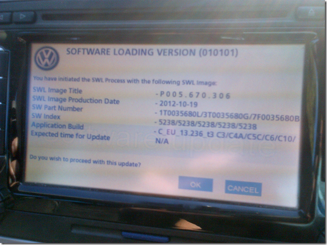

OK check what firmware you have using this video, if that doesn't work you'll have to take out the radio and see what firmware version is printed on the unit. You ideally want firmware 5238 minimum, this can be downloaded from the web or purchased as a DVD with the latest map version on ebay. Note, if you do update your firmware there is a risk of losing your maps (mine didn't) so have your old map software or the latest version handy. Here is also a video of installing the firmware ...
I found this site really useful for updating my RNS510 firmware and maps...
But why do i need to buy it...I have it installed? (Sorry if being thick)
Your firmware may be corrupted in the RNS510 Hard Drive so if you buy it you can try to re-install it and then update the maps to the latest version - worth £13. Boot Loop is a common issue on the RNS510.
