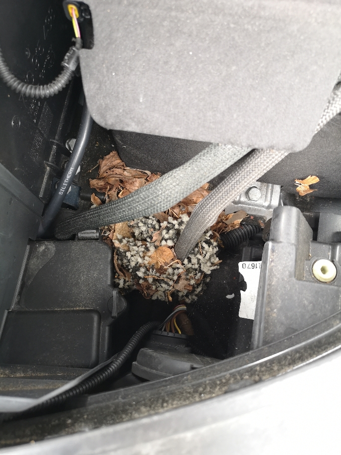

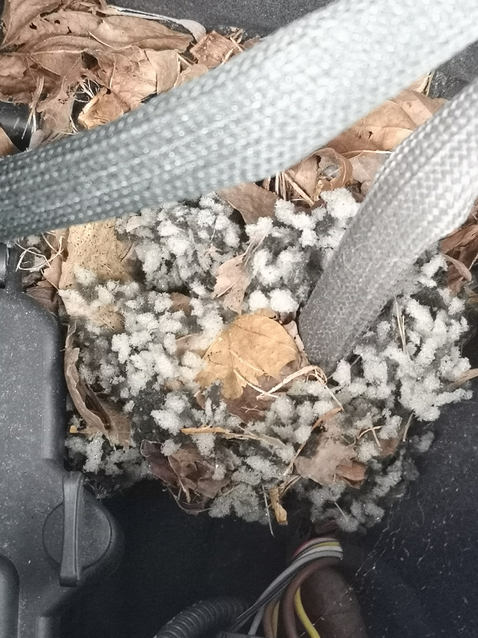

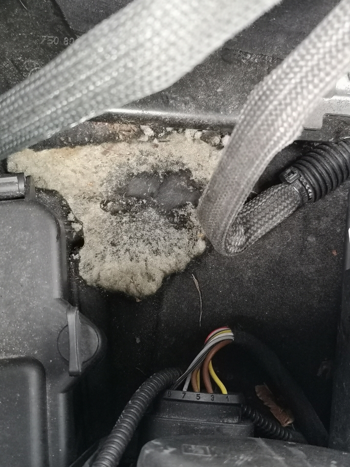

Looks like I have also had an unwanted murine guest in the battery compartment. Hopefully it hasn't chewed through anything important!
