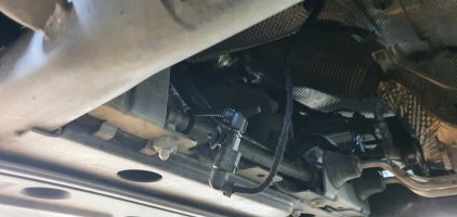

Just moved my van and checked underneath. Surprised to see the oil sensor hanging so low, the VW assist bloke who fitted it after the last fix attack said he had rerouted it higher than normal to help avoid future issues...
Could someone let me know if I'm just looking at a different connector? It looks the same to me. Is this the normal position or has it worked loose? It would be the first thing ripped off if I drove over a stray branch or obstruction on the road.
Also my parking heater doesn't seem to be working since the foxes had their fun. Any ideas where to look to check the wiring?
It looks as though the plastic press stud that should clip into a hole under the van to mount the sensor has become dislodged from the van but is still attached to the sensor. If the VW Assist man repositioned the sensor then that would explain why.
Maybe it would be worth replacing the sensor in the original position and protecting the cable in an outer plastic sheath to discourage the foxes.
