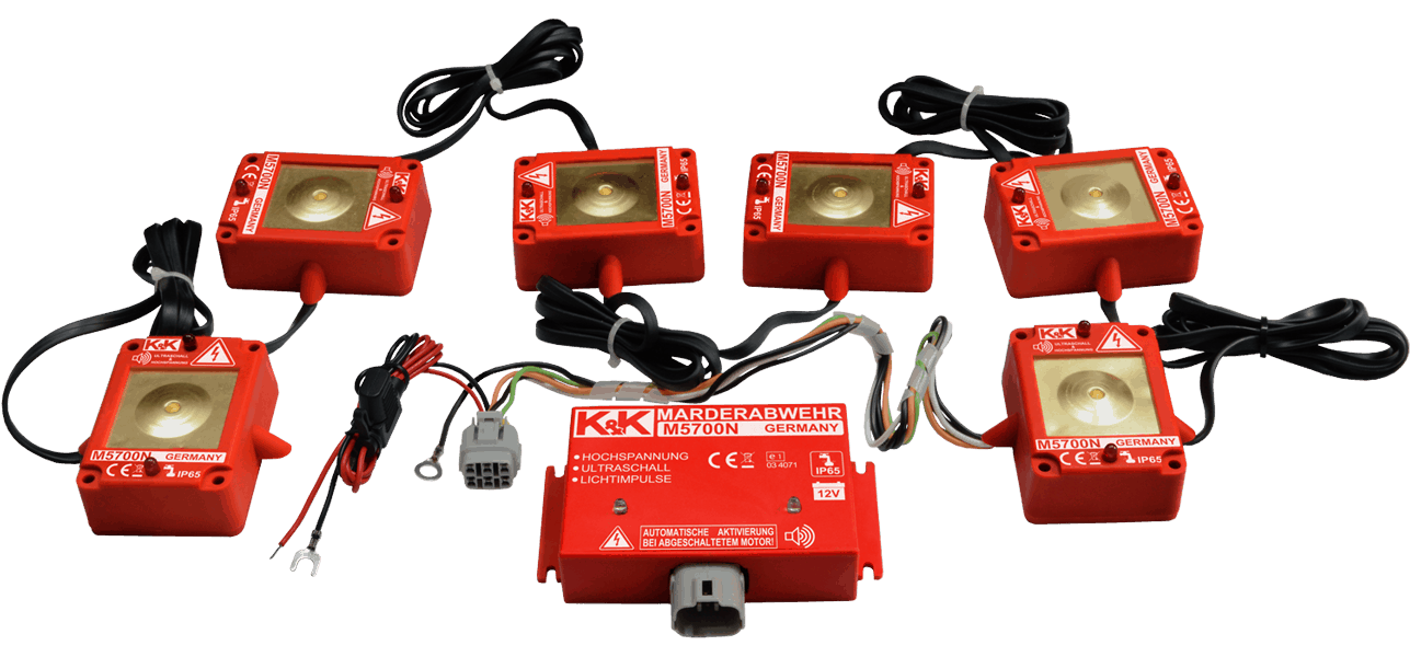

Clearing out 'Bookmarks' on PC and came across this one saved which may help those being eaten out of Cali.
"High Voltage" Could be a useful and effective Scrot deterrent
I think this is what SMG Tonbridge fitted to @oryx white Cali
I think that for anyone with a serious repeating problem this is the only guaranteed prevention kit.
Only become a UK major problem fairly recently to my knowledge.
I fitted one of these to my van myself. Not that difficult if you can get underneath. Runs on 4 AA batteries that last about a year. I didn’t have a problem before with rodents but I thought better to spend £250 now instead of £1;000 for repairs and another £250 for a unit in the future. Plus I don’t worry about my wires getting chewed anymore.
