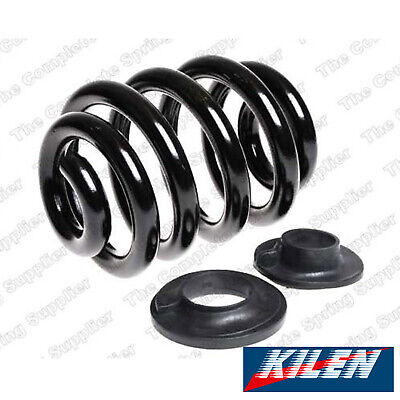

45A912EC-5734-4F67-AE54-0175A695D750.jpegWhat’s the best cure for a saggy arse? Siekel seems a bit extreme .. anyone got any experience of a bum lift?
View attachment 86061What’s the best cure for a saggy arse? Siekel seems a bit extreme .. anyone got any experience of a bum lift?

Hi @alexwhill , this has been covered in the past but if you look at the side bar on your van relative to the ground, it is parallel. Meaning that your van’s arse is NOT sagging. It’s an optical illusion since, as others have mentioned, the front wheel arch on a Cali’ is cut higher than the rear. If you lift the rear the van won’t then be flat on the ground. Try a spirit level on the floor in the living area.

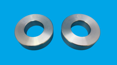

Whatever you do. Don’t let CRS Performance install spacers on the rear springs. It might look level from the outside, it’s not.
The van ends up arse high. Which means, the van is never level for camping. I sleep up in the roof, which means I always need levelling chocks. I’m about to have them removed.

I did a fair bit of messing about with my T5.1 rear suspension before I was happy.
In the end I stuck with some heavy duty rear springs (3 grey stripes) that lifted the rear very slightly (about 5mm) and reduced the saggy bum a bit but without making the van feel nose down.
I also tried some t32 (4 grey stripe) springs but they lifted the back end too much for my liking and felt unbalanced compared to the original springs on the front.
Changing rear springs is a fairly straightforward DIY job.
I also fitted heavy duty shock absorbers which seemed to make a big difference to ride quality but I might have got a similar improvement just by replacing like for like as after 5 years the original ones had seen better days.
I sorted ours with a pair of low mileage T32 springs that I got cheap off one of the lowering boys on the T6 forum. Quite easy diy fit and no noticeable change in ride or handling.
Give me arse sag any day…
The arse high position also raises the center of gravity at the rear, one of the most destabilizing things you can do to such a heavy vehicle.

Spacers under the springs are the answer.
He has 17" wheels which are a size option with Alloys on T5's.
Those don't look like standard profile tyres on the wheels, here's an old photo of mine with the same rims & standard size tyres.IMG_2598.jpg
Not on a California.

Spring spacers = uneven ride height on a California…
It depends entirely on how thick the spacers are.
