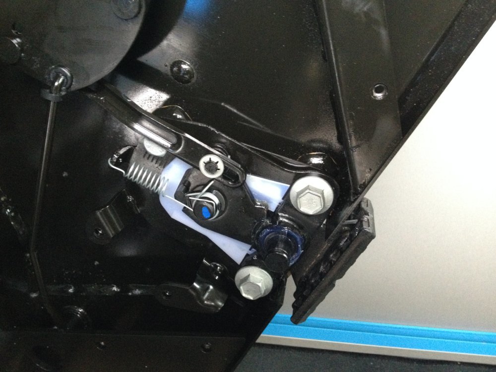

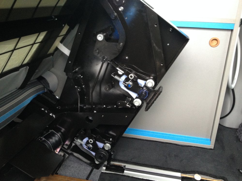

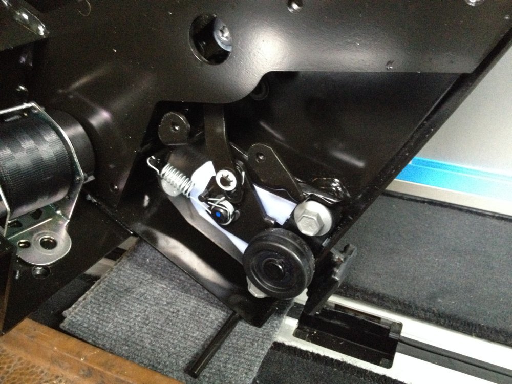

It would be about 2 years ago that I had the seat (base) changed. If the noise stops when the seat is removed that sounds pretty conclusive proof to me. If someone is sitting in the back and therefore putting pressure on the seat is it still noisy? Might help to narrow down the problem to moving on the rails or from the internal mechanism . There are a lot of parts hidden in the sides controlling the slide and tilting . My money would be on an issue there.
Long time ago I posted a photo of the mechanism. Assuming it's not gone after the website update I will see if I can find it again.
Hope you get it sorted
Owen
Hi Owen - did you manage to come across your mechanism photo's I would be interested to see them. Siting on the seat seems to makes a little difference, by the markings left on the rail it would appear that the whole seat is moving. In discussion with the garage as to a way forward. Inspection of the locking mechanism to ensure it is engaging properly and if that fails hopefully a replacement seat/seat base.
Hi Lunar,
I found the original thread that the pics were on: http://vwcaliforniaclub.com/threads/rattling-back-seat.5521/ but unfortunately the post was made on the old version of the forum linking to pictures that were on an album that has now gone.
I will still have copies on my pc at home but need to search through the photo library. Hopefully will be able to do it this eve but am off to Belgium/Holland early tomorrow for a weekend of cycling.
