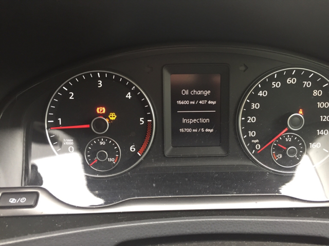

Our van was delivered end March 14, we had our first service with oil change at an early 15,020 in May 15 as we were heading off to Europe for 10 weeks, at that time display was indicating oil change in 9,900 miles and an inspection due in 5,100. Now just over a year later and almost 29,765 on the odometer van is telling me inspection now overdue (booked in on Friday) VW also saying oil change required but van display shows this is due in 10,200 miles which would be 25k between changes???
All very confusing to me, in any event I will have the oil changed on Friday to best protect my engine.
Where do i find the service / inspection info ?. i use the computers 1 and 2 but it does not appear with that info - am i missing something - i have done 10000 miles and i cant see any service countdown or days to next service - thanks
Scroll through the display settings menu, select service then info, it is on my manual page 29.
