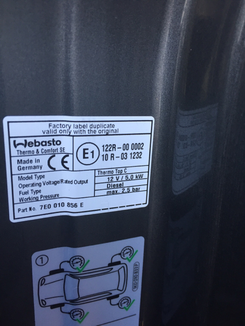

Should I have 1 or 2 heaters?
I was looking in the wrong place I think. Just noticed this on the door (I was looking on the pillar).
So if my vagcom is saying aux heater no flame I probably need to go see my dealer.
Engine coolant heater - auto on when cold to raise engine temp quicker
There need to be second sticker referring to a Eberspacher heater witch is the interieur heater .
The coolant heater is the auxiliary in the manual, I know I don't have the parking heater ;-)
I've been having random problems getting the engine warm when cold yet other times it heats up in ten mins. Wondering if it's not always working below 5c now at least I know it's there. ;)
Yes I do have an air heater but it was retrofitted. In my case a Webasto Airtop 2000. Because of the retrofit I know exactly where the coolant heater is. The company that fitted the air heater routed its fuel line over the coolant heater exhaust. Result that the fuel line melted the first time the temp dropped below 4. Sorted out now but won't be going back to that company.

Hi Gazellio
The air heater is a Webasto Airtop 2000 with the standard rotary controller. Fitted (badly) by Nomad in Horsham. Cost (3 years ago) was £1100. Then spent some more (time & money) getting the fuel issue sorted and redoing the outlet myself to a more OEM look and fixing the damage done to other bits of trim.
Sorted in the end and heater has been a very worthwhile addition.
2016 beach. I have both heaters and both stickers.the webasto auxiliary engine coolant heater to be honest you can probably live without . in Finland it might matter but not here.though it does boost the engine temperature alot quicker. if you have the eberspacher parking air heater that's the one everyone wants when it comes to resale and comfort when yer camping. I'll try take some pics tomorrow for you as to what to look for. later beach dude
