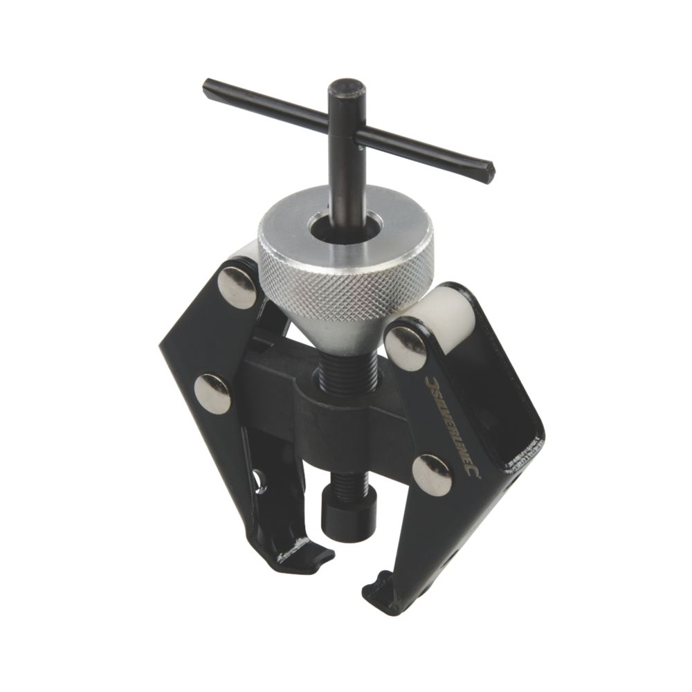

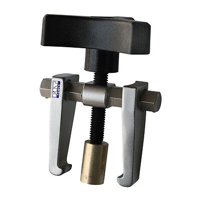

I that doesn't work just buy a wiper removal tool..

Probably worth spending a tenner and getting the proper tool then you won't do any damage.
