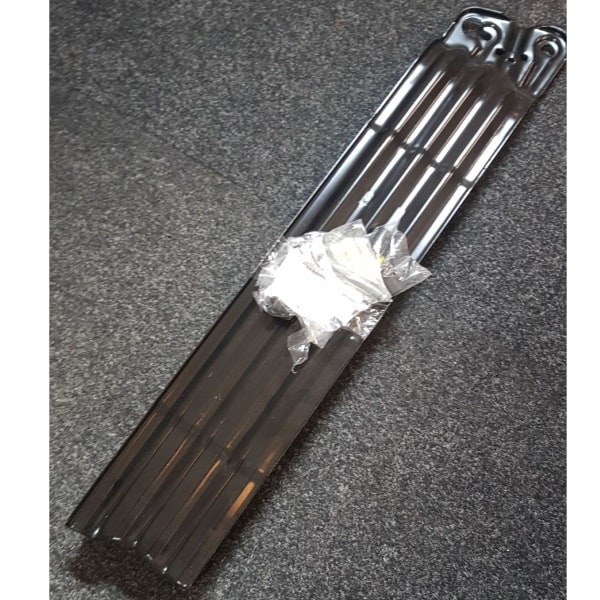

I also got the rack from VW, its easy enough as everything is there
ready for the fixings.
