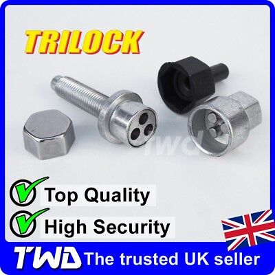

I'm put off by the high cost of shipping to Switzerland (about the same as the kit itself) otherwise it looks like a good idea.
If you have a spare (pun intended) one of these kicking around it will serve same purpose and be visually more appealing
McGard Black Edition Security Locking Wheel Bolts 27181SUB 159 views today
It doesn't serve the same purpose! I could get mole grips / pliers on that bolt & undo it in seconds. The rotating sleeve doesn't cover the whole of the head of the bolt.
You need one of those + a spare safe to protect it.

Thread is probably not long enough anyway. However this is specifically designed for the purpose of securing the spare with a rotating collar to prevent mole grip attack.
A rotating collar doesn't stop a decent pair of grips, just means you have to squeeze a bit harder.
All those bolts are really designed to work on an alloy wheel where the bolt head is sunk into a recess in the face of the wheel.
Put them anywhere where the whole head is exposed & they are pretty much useless.
The spare safe replicates the recess in a wheel & protects the bolt head.

I‘ve read this before and thought I’d test the the theory with my molegrips. Result: However much I tightened the molegrips, the collar still span. So in my test you would need more than molegrips. A battery angle grinder would do it
Well an angle grinder would evade whatever lock was used entirely, by cutting through the frame, so releasing the spare. Pretty sure a rotating collar bolt will foil most casual/opportunistic thieves.
