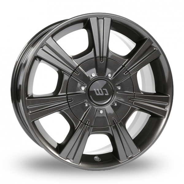

I’m now looking for another set of wheels. 18”x8J. Can anyone give me a fool proof way to identify wheels that will fit my T5.1 with the bigger brake calipers. Is it enough to look for the suitable load rating and an offset of ET50? Or is there still a chance there will be a clash with the calipers?

What I’ve learned so far. Wheels need to be load rated for axle weight = Easy. PCD 120 x 5 =600 Easy. ET or offset is not a complete indicator of fit. Some wheel spokes are more “dished” than others, meaning even wheels with the same offset may not clear your brake calipers. So, I suspect that the only way to be certain is to fit the rim and tyre to see what happens which could prove expensive if wrong. Alternative is to determine if people with EXACTLY the same van have fitted EXACTLY the same wheels. I want some gloss black 10 or 12 spoke 18”x8J alloys to fit my 2015 T5.1 2000cc bi turbo diesel with the larger calipers. So, if anyone can give me some good suggestion please fire away.suggestion
Haven't read all of the thread replies but the early design of Sportline wheels were for the smaller disc front brakes and not for the bigger discs.
I liked the early design wheel but as they were unsuitable for a 204 with the bigger discs I didn't purchase for that reason some 7 years ago. Using spacers wasn't an option that I deemed useable.

I returned the Sportline wheels via eBay and am back with standard 17”. My conclusion was that just looking at the wheel size is not enough. Even if you check the ET or offset it doesn’t guarantee a fit. The outward/inward dish of the spokes also matters. You also need to consider whether you can use your standard wheel studs or if you need longer ones, you could need spacers to make certain wheels fit. I dont like spacers unless they are load tested. So, I concluded that the only real way to know if wheels fit is to put one on the van to check. Or, ask someone who has the identical wheels and van and confirm they work. It was that much hassle that in the end I decided to just stick with the 17” originals.
