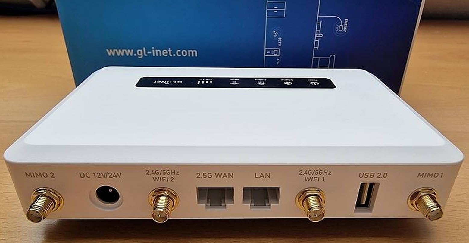

Rear panel
thank you so much this is whatI was looking for could not find a pic of the back!

I just took a look at the Spitz, wow amazing bit of kit, do you know if it can run off 12v? Whats the PSU rating?
DC5521, 12V/2.5A (5.5*2.1mm) [default adapter] / 24V

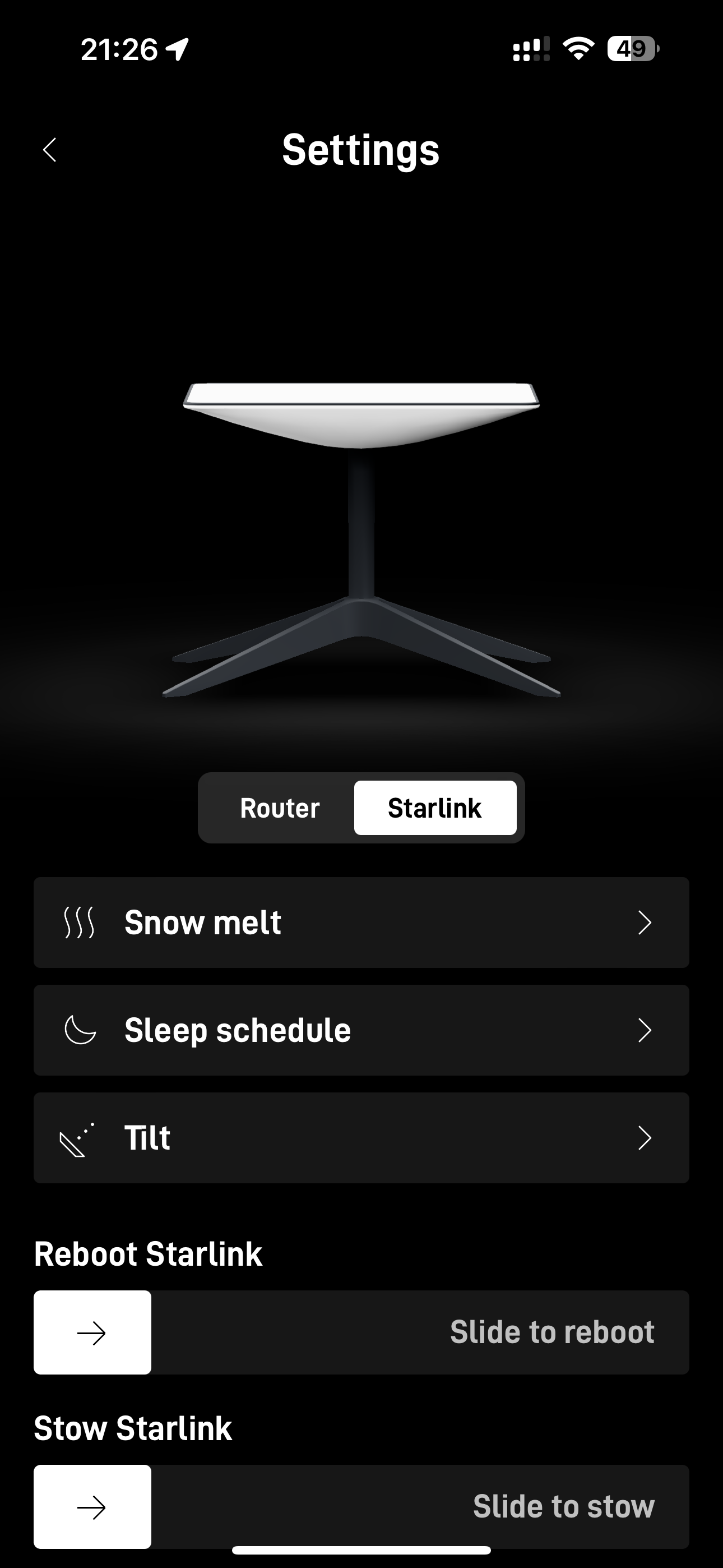

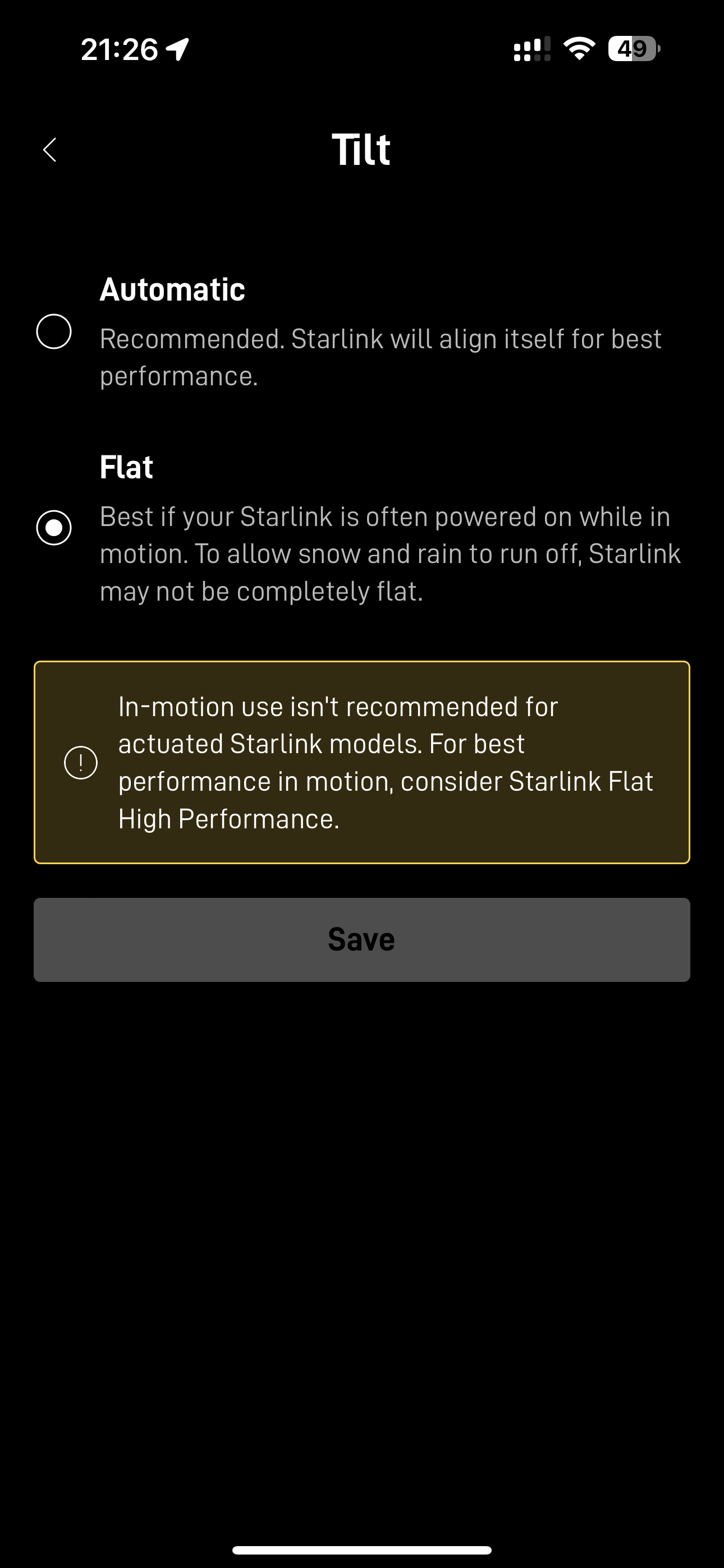

Just noticed a new setting for tilt. This is great! Starlink can now be used in forests and mountain areas as long as you have a straight up shot to the sky. Testing now with cliffs behind me and trees all around and working great! Used to be a dead zone.
Ohh nice.
Just switched mine back on for two weeks while we down deepest south west Cornwall.
I’ll check out the new firmware & SW on Sunday !
