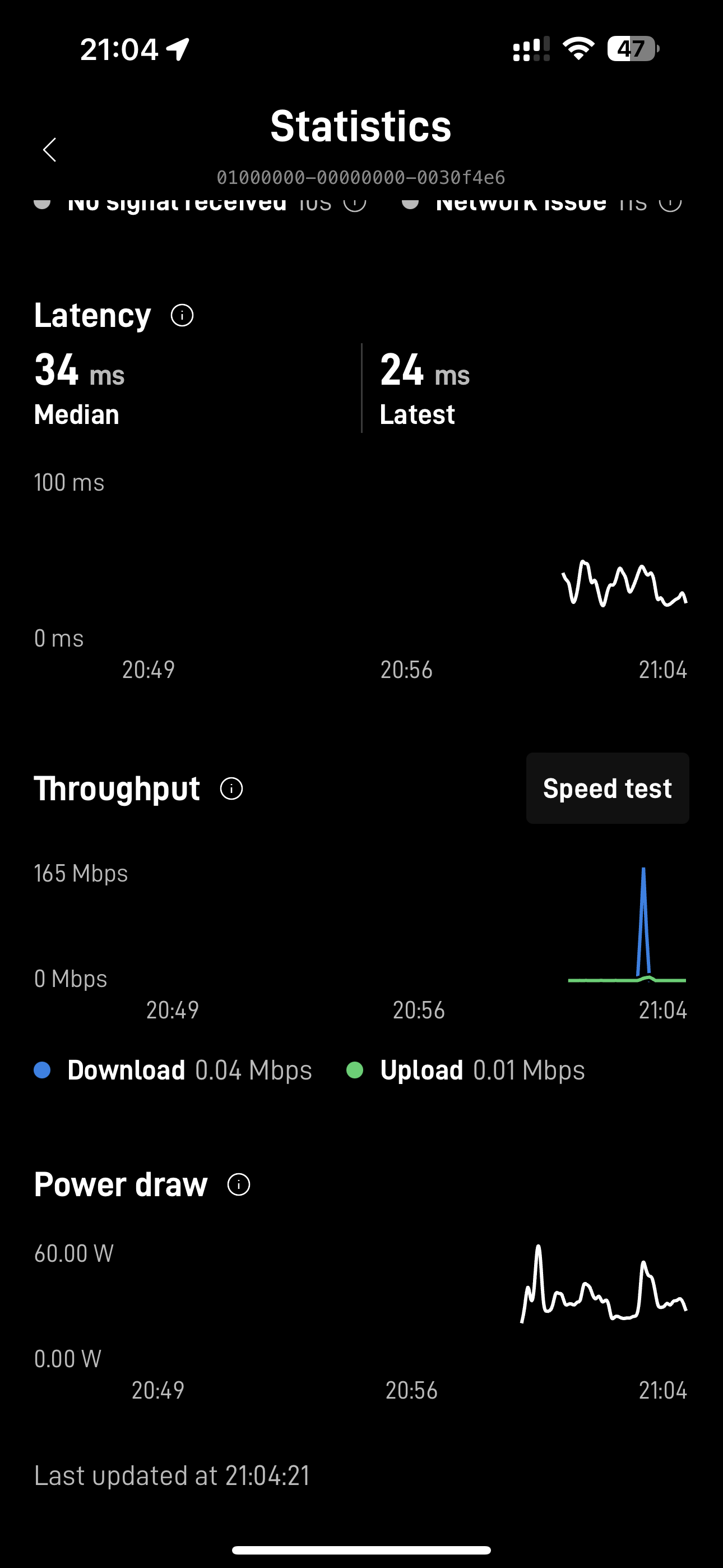

What mount have you used on the bike rack?Picked up a starling mini on the roam plan and travelling to Normandy today. First time use with roaming. Testing at home and all was good even with zoom/teams calls and other activities.
Current mounting on the rear cycle rack with an amazon purchased mount. I would prefer the rail mount on this thread. Will explore options after return.
