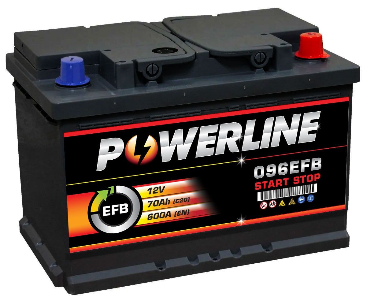

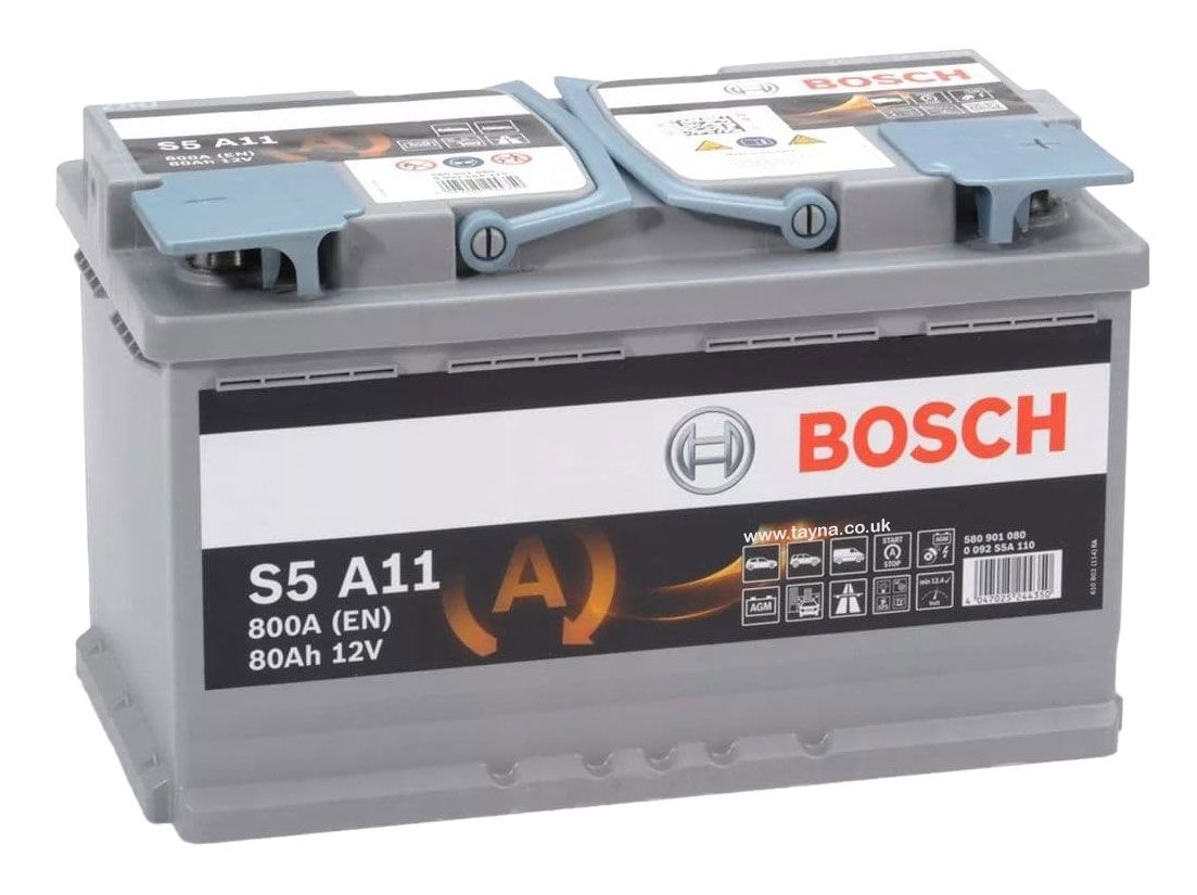

Ok thanks which battery should be installed in my van?? Thanks
That looks fine, just enter your reg on the Rayna battery website and look at the spec, as long as your is equivalent or higher rated it should be fine.
Thanks according to tayna recommendations my battery is adequate. I think I’ll have a look at tge ignition switch for signs of wear/melting. I believe they are prone to burn out. I called my local vw parts suppliers and they told me they hardly ever sell starter motors and suspect it might be the switch as they sell a lot of those. Thanks again
