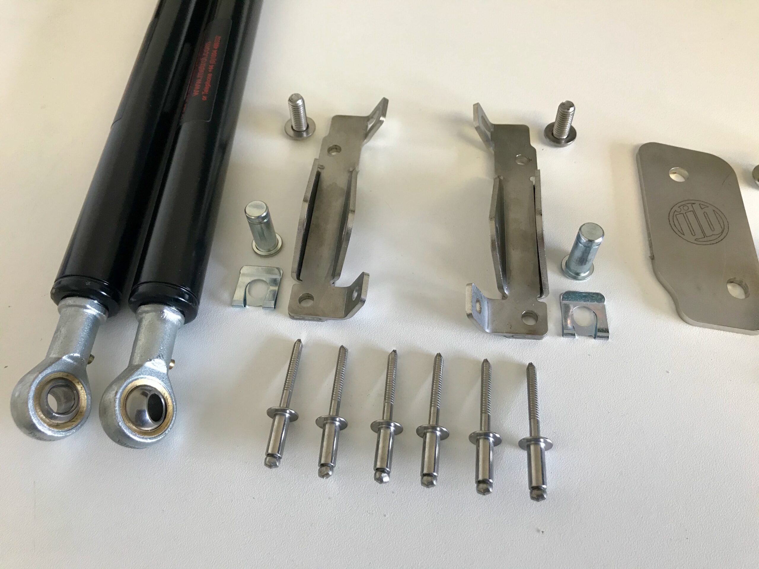

Have a look at terranger.de they have updated struts and updated mounts. May be a bit excessive, but worth a look.
