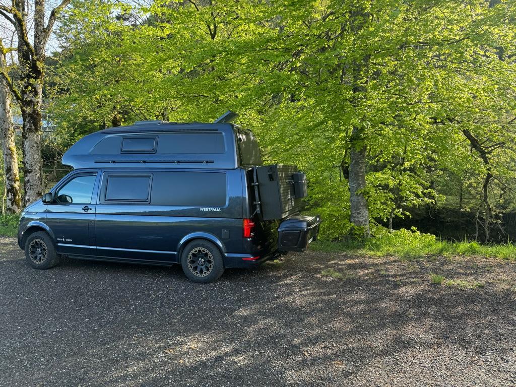

Here’s a photo with both boxes mounted. At least you can see how far out the swing away ball is. My Heckbox is the largest one available.
The rear suspension looks low as it is currently lowered with the auto-level (air suspension)
