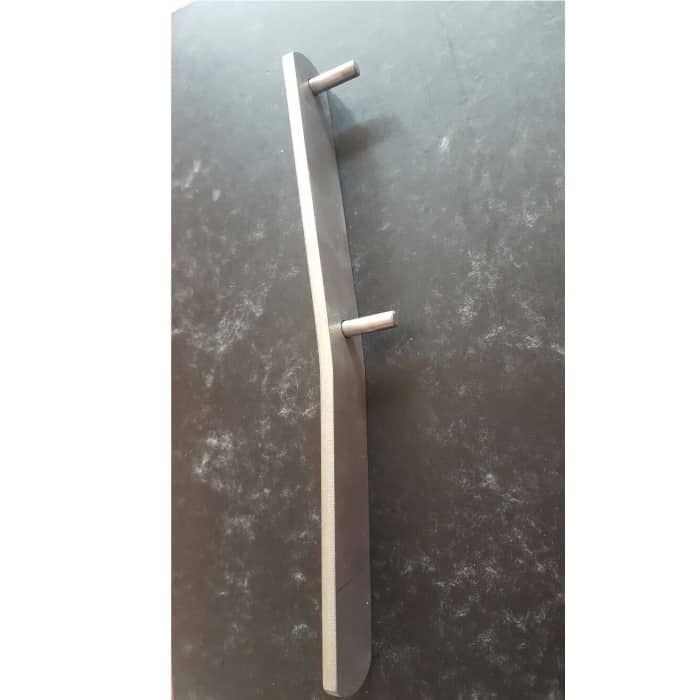

The component with number 4. Anyone was able to open this? There is special way to open it or I have no enough strength?
You’ll need something like this. Flat piece of metal with 2 bolts correct distance apart. Similar to this Clean Water Tank cap tool.
