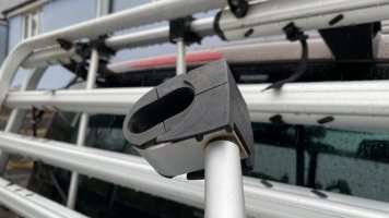

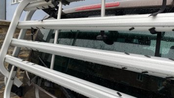

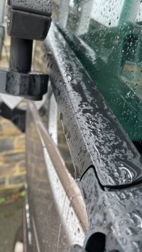

Hi, thanks for the reply. Here’s some pics. There is little to no clearance for the rear wiper. Then I have the space arm that I don’t know how to attach.
Appreciate any help.

Looks like your space arms are the wrong way round. I will send a photo.
Photo as promised.

If you unscrew the black knob at the end, you will be able to move
the bar along to give clearance for the wiper.
The bar that you have in your hand will need unscrewing fully and
then fitting back on to the rack.
It could be that the last owner only ever carried 2 bikes so removed it,
the fixing arms can all be slid along to whatever suits your needs.
Yours is the newer T6 version, when you do use it
don't trust the wheel chocks with straps.
Better to add extra straps through the wheels yourself, there has been
a couple of failures posted on here.

@KBR I suspect your "bike arms" are installed incorrectly. I attach a photo with an overlay. The overlay (in blue) is how your arms are installed. This is incorrect. they should be installed as in the photo.

I attach a photo and a schematic that might help your problems.
The four bike arms do not need to be in this order.
Hope this helps.
This is great thanks. So to detach and reposition them, I just need to fully unscrew the knob on the opposite end to where it’s attached?
Yes, that should allow you to disassemble the end attached to the horizontal frame bar and reassemble in the correct way.

Certainly looks like the arms are on the wrong way round. If you turn them round they fit tight to the bike rack and away from the rear screen and wiper. As far as the bolts seizing up they do and a careful squirt of WD 40 should get them lose. I normally take mine apart every year an re grease them and give them a good clean. The T5 and T6 racks are different designs.
First part done, managed to remove all the arms. Will clean and WD40 them then try and put them back on correctly. But that will wait until after Xmas. Thanks all.
All sorted I think. Got them taken apart with a bit of WD40, cleaned off some corrosion, greased, re-assembled and put back on the right way now I think! Looks like my rear wiper now has clearance... although I need to get that fixed as it does not work since it hit the bike arm pre-Xmas. Hope it's nothing too expensive gone wrong.
