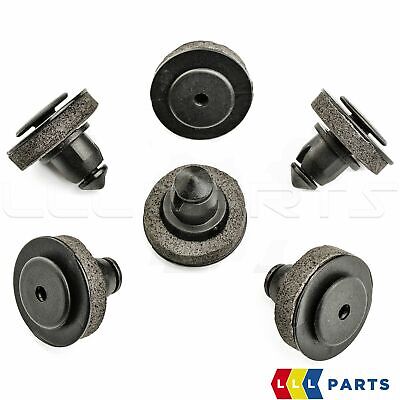

Hi, What was the part number for the external trim panel clips?
UPDATED Now found ...
Volkswagen Transporter T5 Clips for Sliding Door Rail Cover 7H0843658A
Might have been my lack of skill but i found those trim clips a complete pain in the backside and the cause of much swearing!
These ones were much easier to use and a better match for the ones on the van
Glad I ordered some of the panel clips you mentioned as the original ones I bought just wouldn't go on. Thanks!
