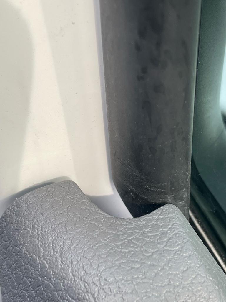

I’ve had the same recall (door cables and infotainment issues) but the fix from my dealer wasn’t done very well which resulted in a noisy rattle in the door. It was like a spanner had been left in there!
A friend who does conversions said that putting the door panel back on is awkward and said the gap in mine at the top showed it wasn’t on properly. So I booked an appointment with the dealers for them to take another look, and also clear the service inspection message that they’d not cleared from the last service.
I was told all had been resolved and duly collected my cali last night. No sign of the rattle (yet) but the top of the panel is still showing a gap that can be squeezed.
Had anyone else had the same experience. Should I book another slot with the dealers or am I just being unreasonable?
