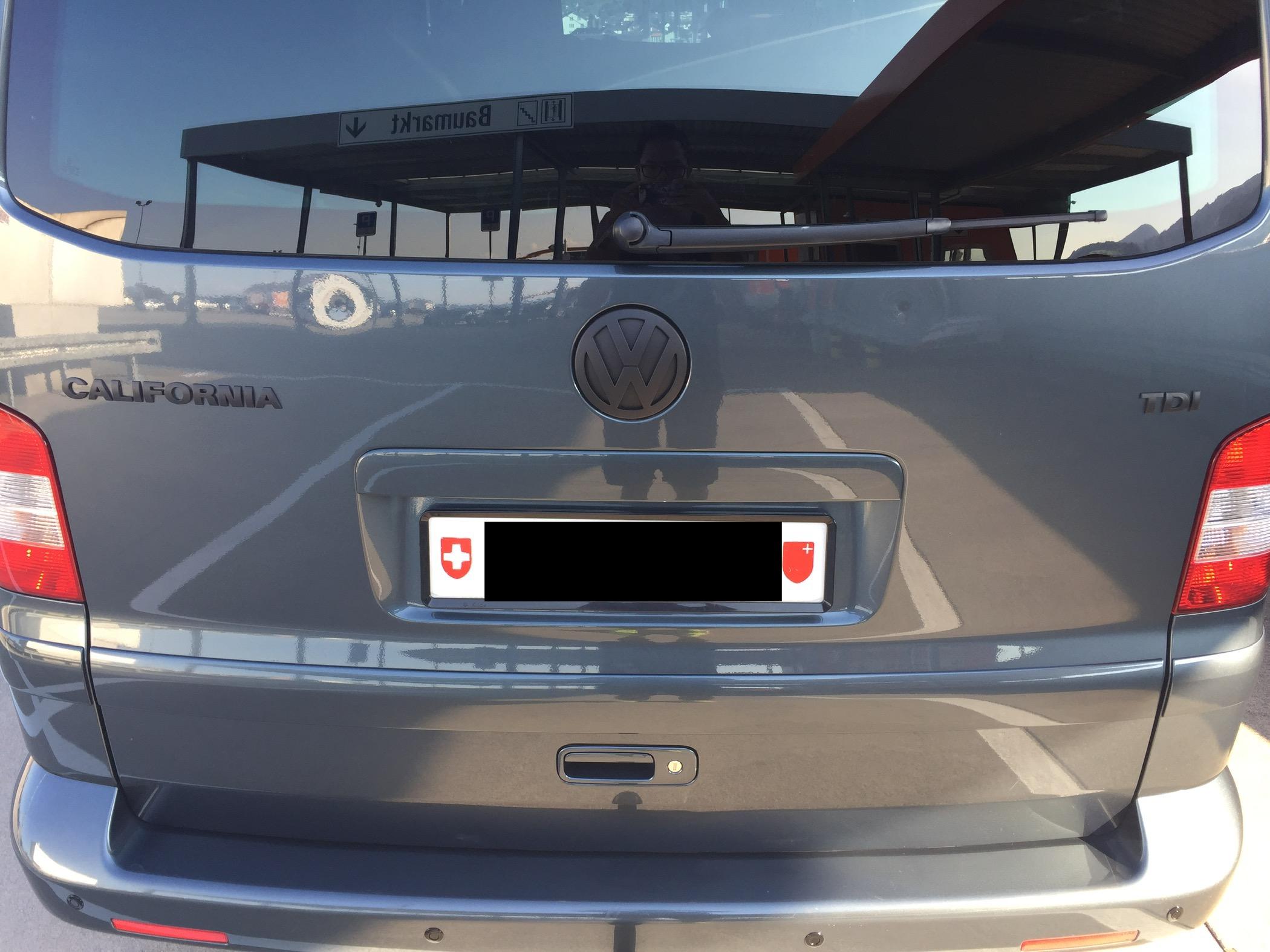

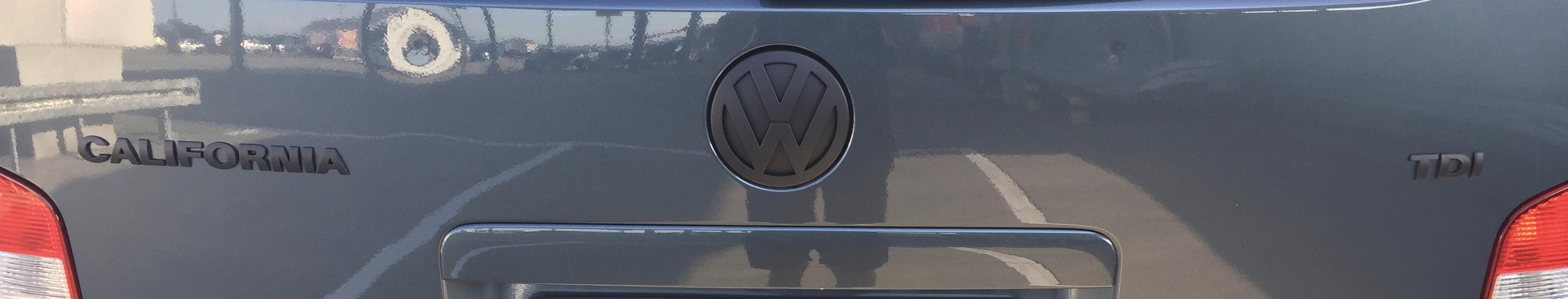

That’s the badges, the smaller one is for the back and that is just stuck on. The front has clips I went matt black.
I’ll be stripping my rear badge and colour coding like I did in my last van

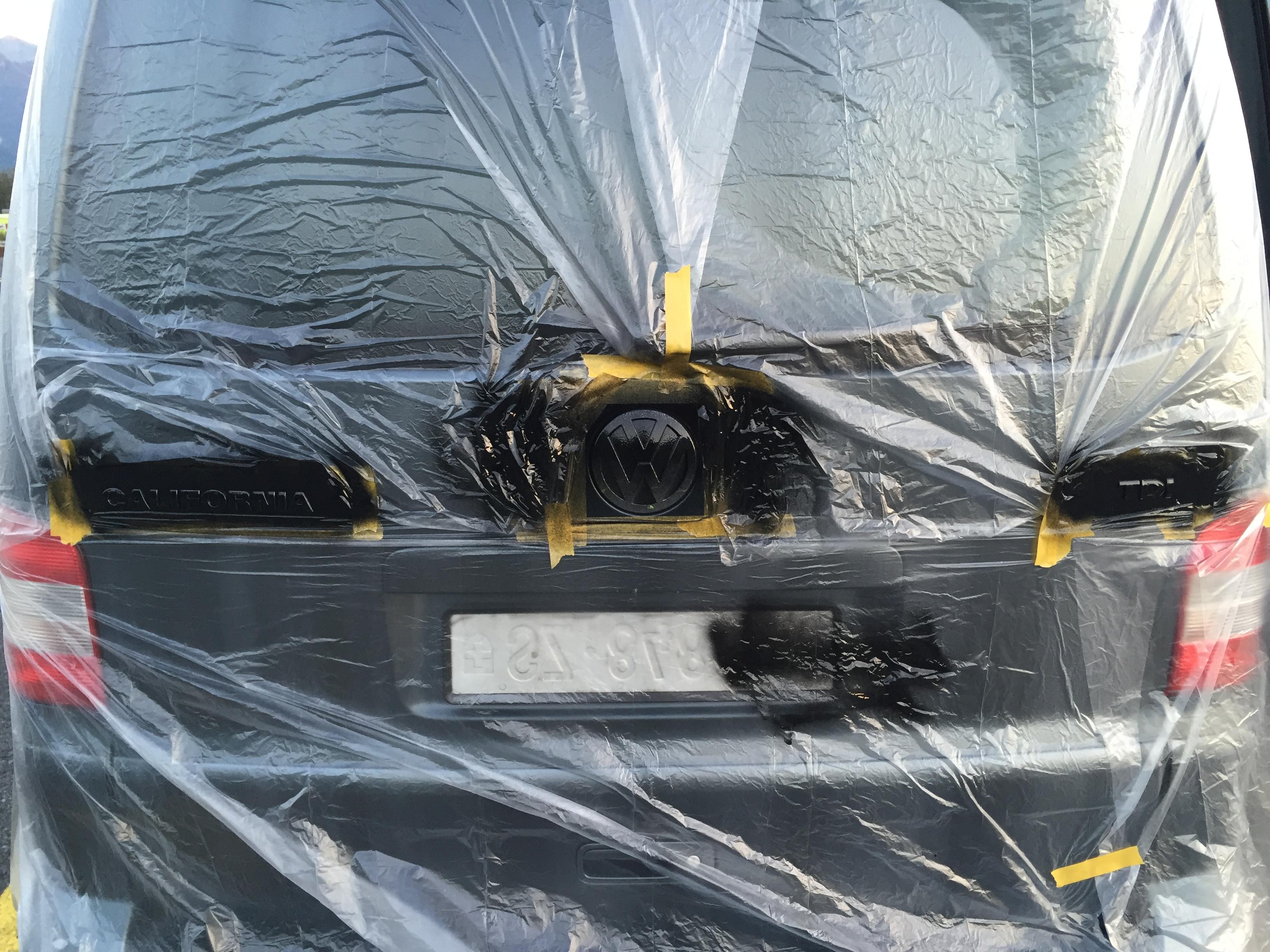

Plasti Dip anyone?
I didn’t fancy the full gloss grille thing as the lower ones in gloss look like they could be a bit ‘high maintenance’. I bought the THQ 4pc gloss black inserts. I 3M wrapped the chrome inserts above and I’ve plastidipped the front and rear badges (but think I may go gloss black if that doesn’t hold up).
As an aside, the THQ parts came in a cardboard tube which, hands down is THE best tube I’ve ever received, for doing Darth Vader impressions - worth it for that alone!
If anyone cares; you don’t have to remove the entire rear badge which is stuck on. If you slide a thin knife under the ‘V’ and gently work your way up and around it separates from the base and can be clipped back on. I’ve seen quite a few posts online saying the badge is stuck on and you heat gun it off etc but you don’t need to if you’re just changing the chrome part. I’ve done this a few times and T6.1 is the same as T6.
Looks good. I agree with you on the Plastidip Gloss - it’s a bit orange peely and not quite gloss. Maybe there’s a knack to it.
Maybe yes, have used the regular stuff for years with good results, just couldn’t get on with the gloss.
