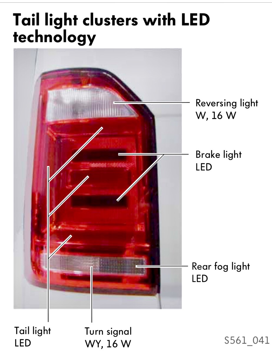

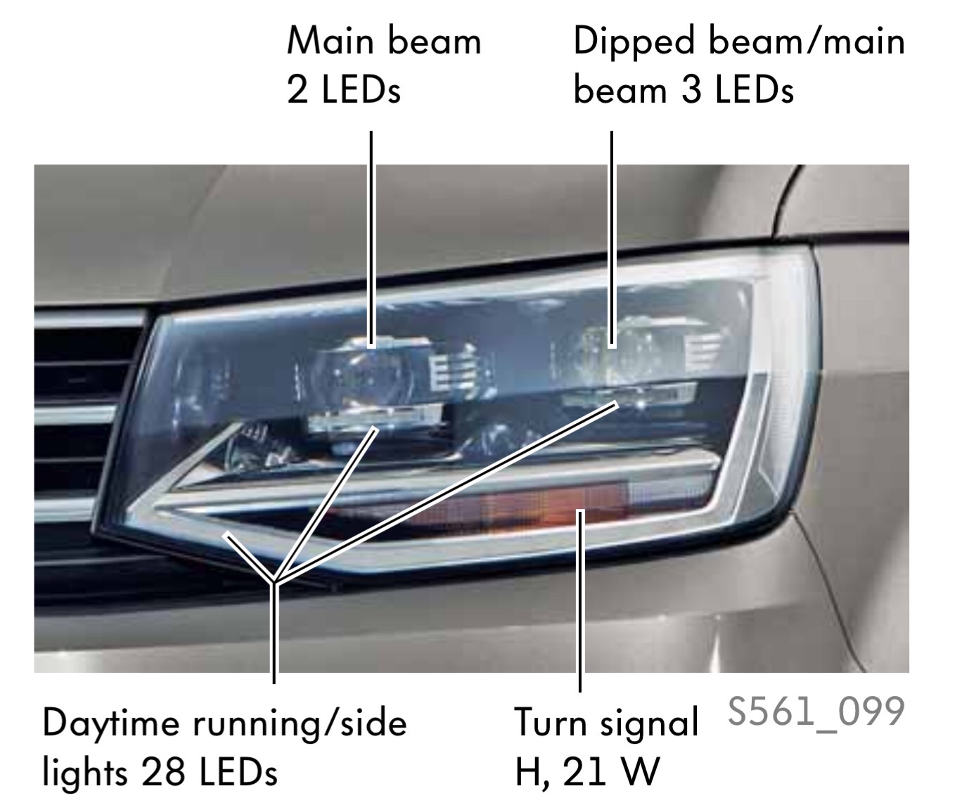

Personally I like to have everything to hand as my organisation can sometimes and I mean sometimes overcome my stupidity. So below are for T6 with LED lights.
It's nicked from @Loz PDF he posted.
