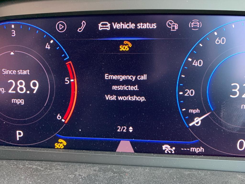

Has anyone noticed if their button flashes on occasions ie 1. Flash every so on?

No but occasionally the light goes red when I start the van (normally green). Switching off and restarting normally fixes it. I can live with it but will flag it when it goes in for a service. Suspect it might be a random Bluetooth pairing issue with my phone?

Mine has initiated a few SoS calls at random - a message flashes up in the middle of the dash display, but goes out again within a second or two.

Interesting Andy. I don’t get the dash display message (other than ‘telephony unavailable’) but the overhead red light stays on occasionally.

I had the SOS system go red and flash a fault on the dash, but next time I started the van and since all has been green with no faults.
I get this fairly regularly. Booked in to be looked at but reading the articles above I don’t hold out much hope!

interesting.. I’ve had the red SOS light and message twice, and the sat nav go awol by about 10 miles another time. All have cleared after stopping for a time and starting, but pretty poor if VAG knows about the problem but is still selling vehicles with this issue.
I had that today too. The usual green light next to the red emergency button on the control panel above my head was red.
There was also a yellow triangle with an exclamation mark (!) at the bottom middle of the dashboard.
I stopped at a supermarket on the way home and when I restarted it was all fine.

Yes just turned the van on sos unavailable fault visit workshop,contacted my local Van Centre again it’s a new control unit common fault they said.

Have notified the dealer of the fault, advised to let them know if it happens again and they'll get it booked in to be looked at.
Took our Cali into SMG Cowfold yesterday, picked it back up today for them to look at the 'Emergency Call - Visit workshop' message among a couple of other things.
They told me there's no fault and that if you have no signal when you turn the vehicle on that's what it will do. I pointed out the obvious holes in the story - i.e.
  • so you'd get a fault saying you needed to visit the workshop every time you turned the vehicle on if you happened to live somewhere with no signal
  • it doesn't then resolve its-self if you drive somewhere with signal

That totally tallies with my location when it happened. And living where I do, not even remote, we have poor network. I’m lucky that doesn’t happen on my driveway...!!
So on a trip, basically if it switches off, as soon as you reach an area with connection you need to pull over and restart the engine... yet, if you travel into an area without signal, the green SOS lights stays on...
Totally Bizarre...
I have had no issues with the sos fault since ,but the van is booked in for the control unit to be changed, i have postponed the repair last week thinking it might be ok going forward should i cancel the repair, could the fault have be a one off?
I’ve not experienced the fault for over two months now. Just seems to have gone away at least for now - I don’t know if there was a software update applied over the air or by the dealer.
