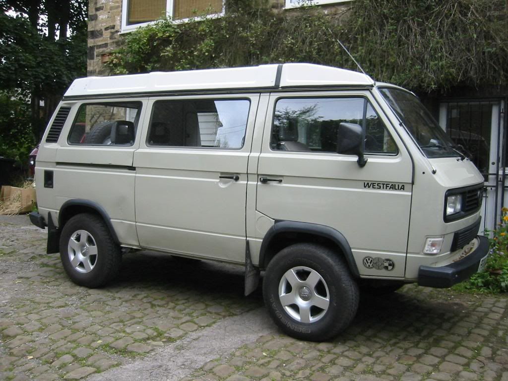

Off roading can be rough, I did it in military service for 15 months. I wouldn't use Cali for such driving, unless it is already written off. Old Syncro is something that I would get for it.
Those Syncro's are the muts nuts!
