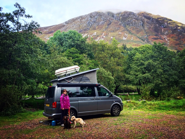

I used a cheap box on our Scotland trip on my beach. I found the bars do make a difference to MPG, but the roof box didn't decrease it significantly more. I had the box near to the back to enable it to still pop etc. The VW roof bars are quite high but I dont really have any insight into lower ones being better.
The biggest challenges for me was that we had to empty it each time we stopped to enable the roof to go up and even when empty it was a slightly saggy on the rear. We also had to carry a ladder with us. I was too worried to use it propped as it was so hard to move I was scared of warping the roof. 50kg limit for me is when its down, when empty you have about 20kg of bar and box and thats too much for the struts imho.
More than welcome to borrow the bars and box if you don't want to invest.

Thats the sort of box i had in mind - shorter / stubbier than these slick ski type boxes. I was thinking about mounting it right back - allowing room for the hatch to open but not much more. That would put it above the scissor units and therefore the most stable / strong part of the roof - i accept your thoughts on the total weight on the roof, but i was thinking id put mainly light items up there - clothing etc. Thanks
That roof box was a gumtree buy for about £50, cheap as chips. It is pretty low tech, I carried a small pole inside to prop it open and it is lockable.
That pic shows it as far back as we could get it. I had a cadac SC2, 4kg gas bottle and our lightweight awning up there so quite heavy things, which with the bars and box was about 45kg. Near the end of the trip some of the heavier things went back in the rear of the van whilst travelling (easier to put them outside) and we put our dirty washing bag and similar up there.

EDIT: We have an OCEAN- If you have a BEACH or COAST with a manual roof, you might meet a challenge to keep the roof up, if the box is full. A supportive stick might be of help?
The T6 struts may be a bit stronger than the T5.
I have no idea vs T5 but wintertime my T6 could not hold a roofbox and bars at all.
