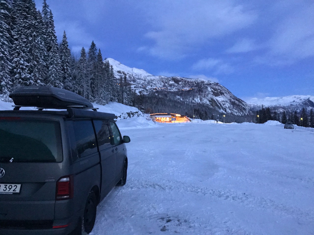

Apparently, roofbox while camping wintertine with a beach is not a good idea.
Anyone noticed how gas struts seems to be less agile in winter? Maybe your rear hatch wont stay up? Imagine a California roof with a roofbox and three pair of skiis and ski boots, no go. I took out the boots, then I could actually lift the roof but it fell down right away. Skiis out, it stays up if bed is up stabilizing it since they are warm from the heater inside. I am lucky its just med and the boys so we can all three sleep downstairs. Right now I am not in love with my Cali.
I stuck a 6' by 10' cotton tarpaulin in with one chair and the roof topper in with the other chair and now my hatch won't stay up. Heaven knows what it might be like loaded with two Bromptons and two toy bikes.
Won't stay up, I'm afraid.
It will improve as temperatures rise but doubt, even in the South of France in he height of summer , that the gas struts will be able to hold up a fully loaded bicycle rack.
You could fit uprated gas struts but then it will become extremely difficult to close if the rack is empty.
If your vehicle came with the rack then it should have uprated gas struts to compensate for the rack weight, 1250n rating I believe.

Check you have the correctly rated gas struts fitted on the tailgate.As other vehicles in the T6 range with a tailgate are fitted with Lower Rated Gas Struts and it is not impossible yours has as well.
As our roof could not be held up tonight me and the kids, 6 and 8 yo, slept downstairs. As always I am in bed listening to all kinds of sounds, but I could not hear the fridge under us. I turned the heater off att 22:30, at 3am it was 2 degrees. I can recommend the Sense Peanut to be able to keep up with temps.
Nice way of saving energy :)
Waking up with this view makes me like the Cali again:
