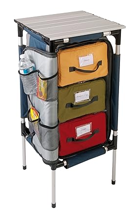

I have two of these, and we dont use the stands much but use the drawers/bags a lot...
