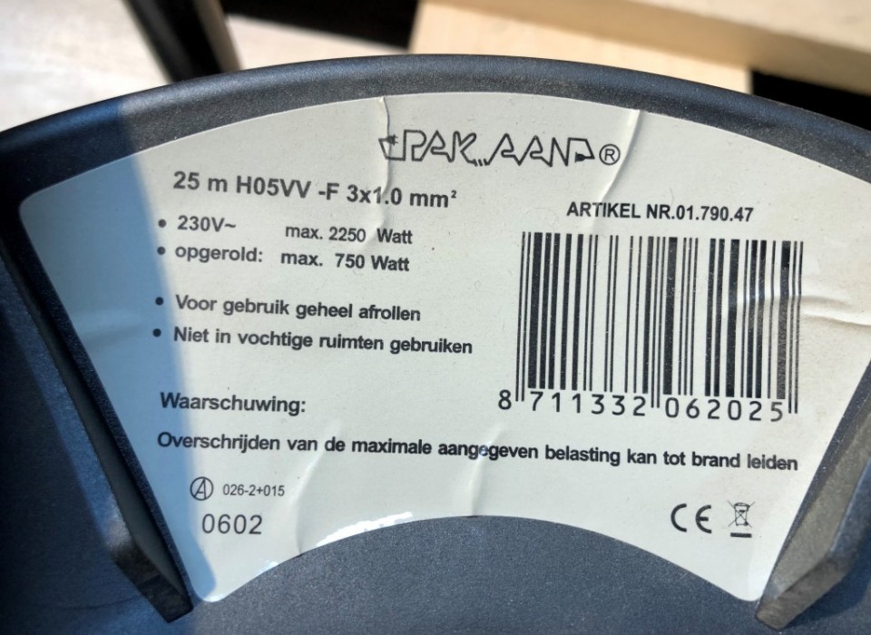

Also, have a look at your cable reel if you own one. There's a good chance that there's a sticker on it, saying how much wattage it can take when unwound and when wound. Te difference will be somewhere around a factor 3. For example: 2250 watt unwound and 750 watt wound.
The reel should also have a thermal cut out button, which should activate if there is too much heat; If that button fails and the wires inside the cable melt then your earth wire could become live, so as long as no one is touching the metal bodywork on the van during this time then all will be fine. Of course the Campsite RCD should also have tripped by this point provided all has been wired correctly.
