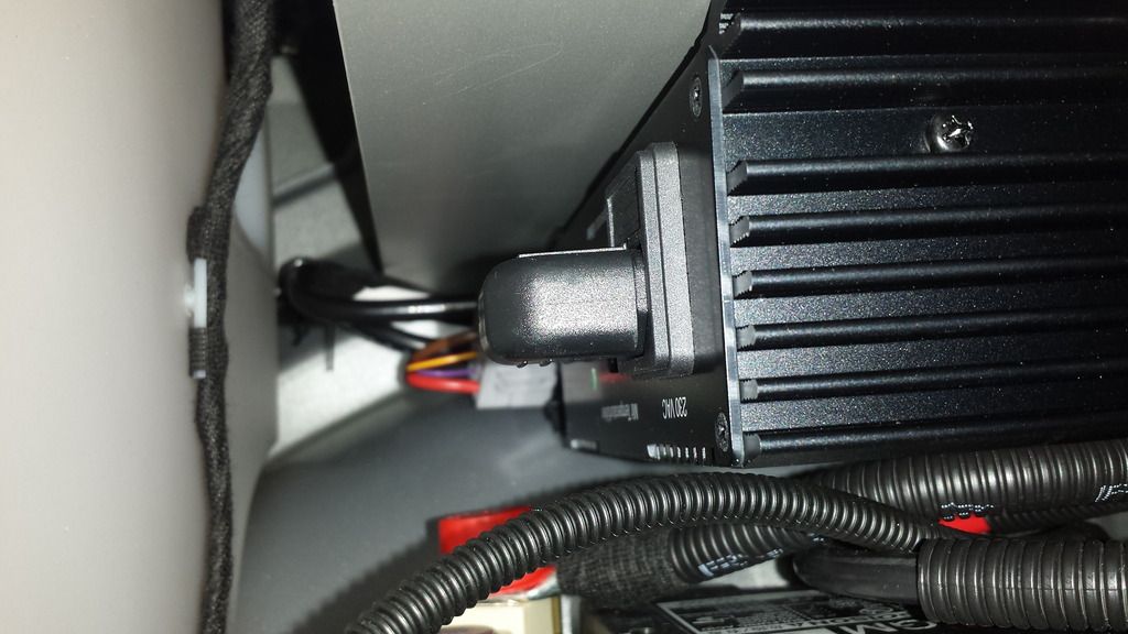

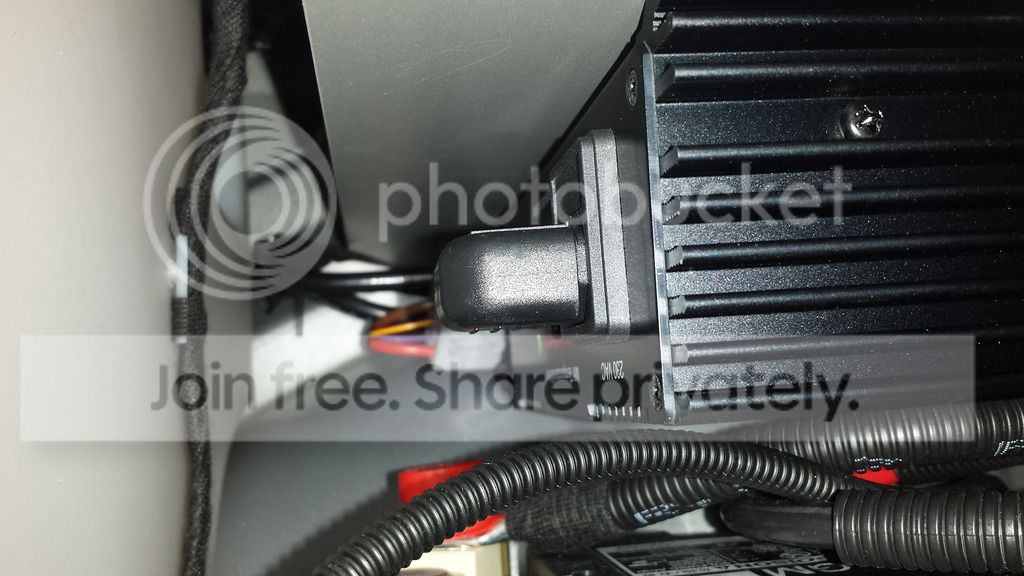

I did try wiggling the plug earlier as I read your advice in a few of the other posts. I've just tried it again and taken the plug out and put it back in. Still no joy... 12V showing.
Is there meant to be a gap (of 1-2mm) when the plug is pushed in, or should it be flush? (Mine has a slight gap, hope the photo shows this as I had to use my lantern to take it!)

Looks like your leisure batteries aren't charging, if they were charging it would read more then 12v (volts) and read a number not - number A (amps)
Do the volts go higher and you loose the negative on the amps when the engine is running and you get the "G" symbol instead of the "plug" symbol, then if so the leisure batteries are charging from the engine
Is the vehicle under warranty, may be a trip to the dealers.
snowy55: thanks for the reply, came in as I was posting my other reply to WelshGas.
Yes I get the G symbol when I start the engine so it does charge from the alternator just not the hookup, and yes it's a brand new vehicle (I'm the odd one who keeps sleeping on the drive and hasn't been anywhere yet!)
Thanks... Susi

Thanks for your input, if anyone has any other ideas (or can confirm whether that kettle type plug fits in a flush way or a 2mm gap way) I'm all ears!
Many thanks snowy55. I won't try to wiggle it any further in then
