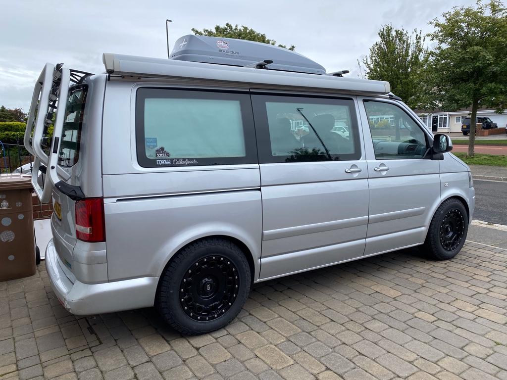

I’m in the process of making my 2006 SE 2.5 more off-road capable, without going too crazy considering it’s 2wd and I am realistically on the road most of the time...
I have already fitted new wheels and semi AT tyres at 235/65/R17 which are a little larger overall than before due to the large sidewall.

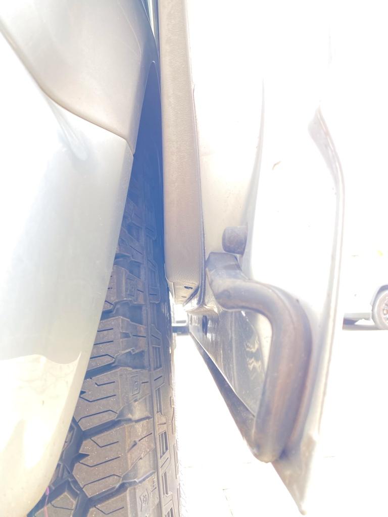

First issue...This has caused the sliding door to actually rub on the tyre for the last 5 inches or so, but it still opens and locks in place. Looks like raising will reduce negative camber and get it to clear, but raise by how much? read on

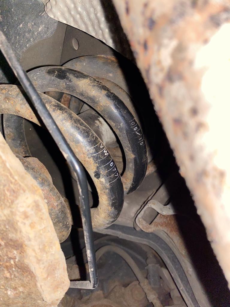

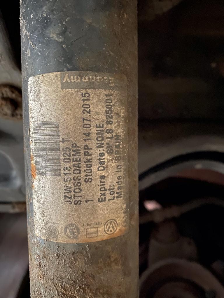

I had a look to confirm the suspension, which I knew was lowered already by the previous owner. The springs I think are VW code 677 (Eibach?) 30mm lowering springs and the shocks say 2015, (I think they are Sachs made VW units?) so I guess they were put on with the lowering springs and aren’t nearly as old as the van.

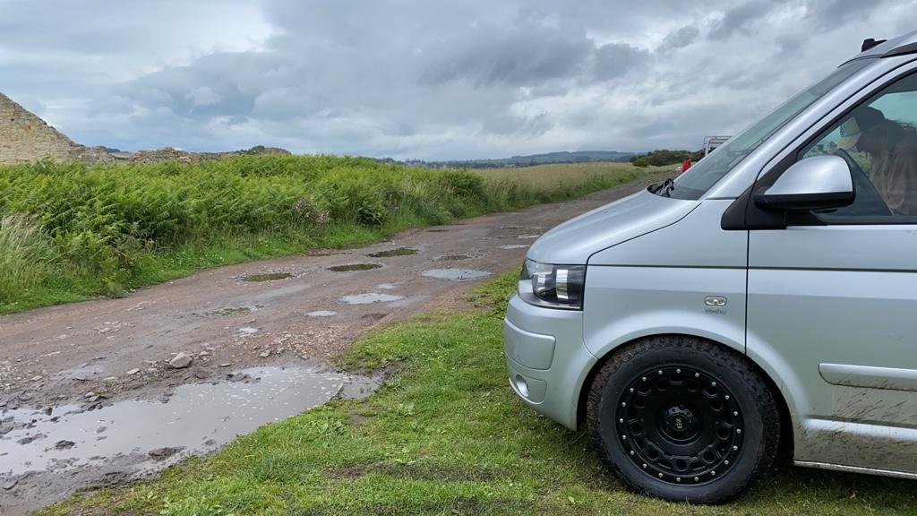

I want to retain a decent handling feel on the road, but be able to tackle unpaved roads like below without either wallowing or bottoming out and bouncing everywhere. stuff like this as a start this past weekend

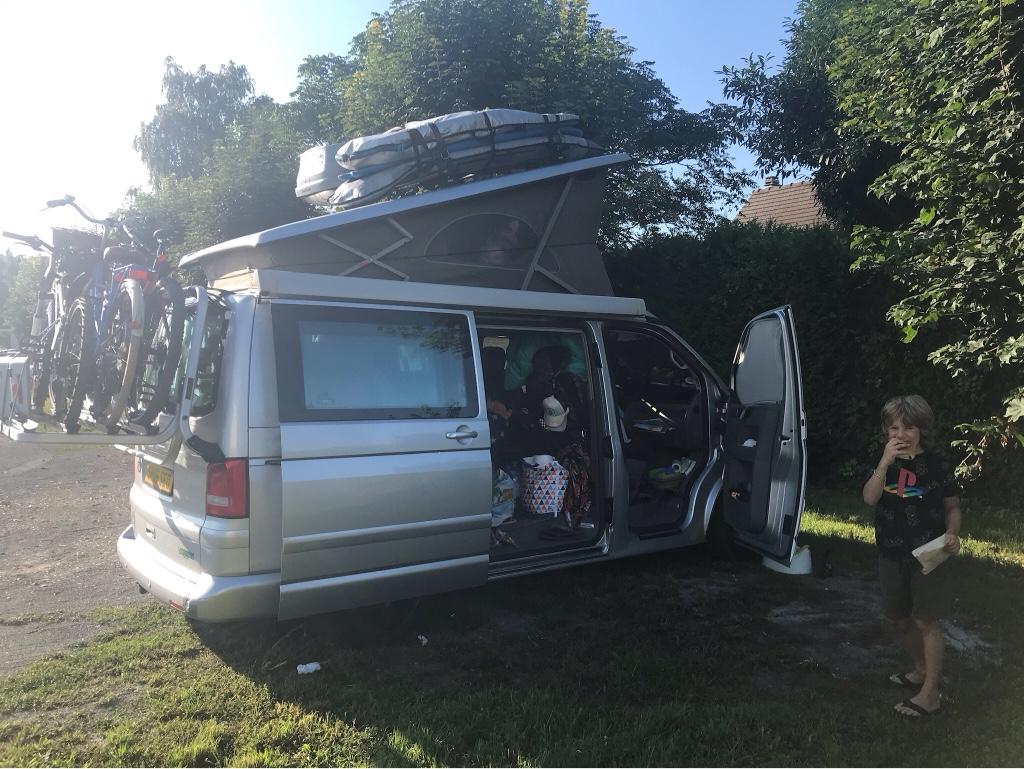

Last summer I clocked 55 hours behind the wheel over 3 weeks through Europe with wife, 2 kids, 3 bikes, 3 surfboards, roof box with hexaway awning, lots of wine, you get the idea...FULLY LADEN, so I also want on-road highway manners to deal with this well for our big annual trips.

Hopefully that describes my requirements enough for your expert advice. The original stock springs (**not** what’s fitted now) were codes 0JE / 0YD on my sticker, which apparently are 1 grey+1 green front and 1 white rear.
I have a friend who has offered me his unused 2016 T30 Kombi springs since he lowered his from new, which are 2 grey+1 green andwaiting to hear tomorrow on the rears are 1 blue + 1 yellow.
I also have an offer from a CC member who has some stock springs same fronts and 2 white rear which are also code 0YD on post 2011 vans according to parts sites, which show my 1 white as the pre-2011 version. I have searched around for the spring colour codes and have the link to check them but the info isn’t that useful, i guess an extra grey mark means they are slightly more heavy duty?!? ¯\_(ツ)_/¯
a question; is bothering only with stock height springs a good first port of call, or should I be looking at replacing the shocks at the same time so I don’t waste money redoing it if I’ll likely not get the result I’m after?
I’ve read that Bilstein B6s improve handling, Koni’s maybe even “better”, whatever that actually means. I’m not sure if they pair with stock springs though or are even suitable for my semi-off road purposes. Most people seem to fit them for better handling when lowered for road only.
