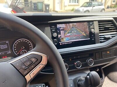

I thought you already had a screen and parking sensors and you were just trying to get a camera that would show up on the existing screen with the sensors overlaid like this i.e. as per factory spec https://vwcaliforniaclub.com/threads/reversing-camera.14155/ ?
