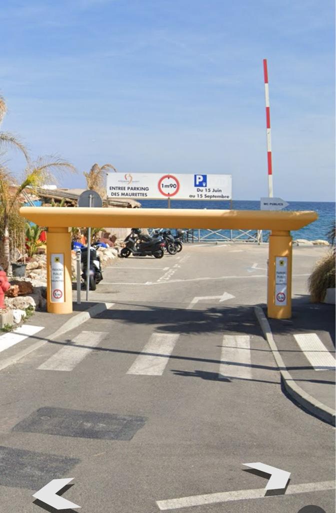

Just to clarify, i show you a tipical situation we faced in south france:
(So the need would be to ride low for only 5/6 meters)
Please note that sometimes I success to enter in some of this (i’ve got 17’’ wheels and standard suspension so perhaps somewhere these “barriers” are set at real 2meters, sometimes not)
