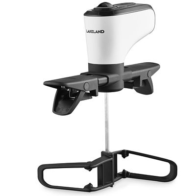

Any way I have solved the OP problem buy this:
