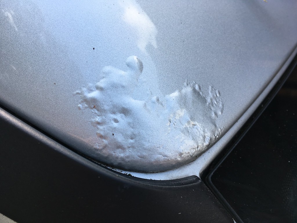

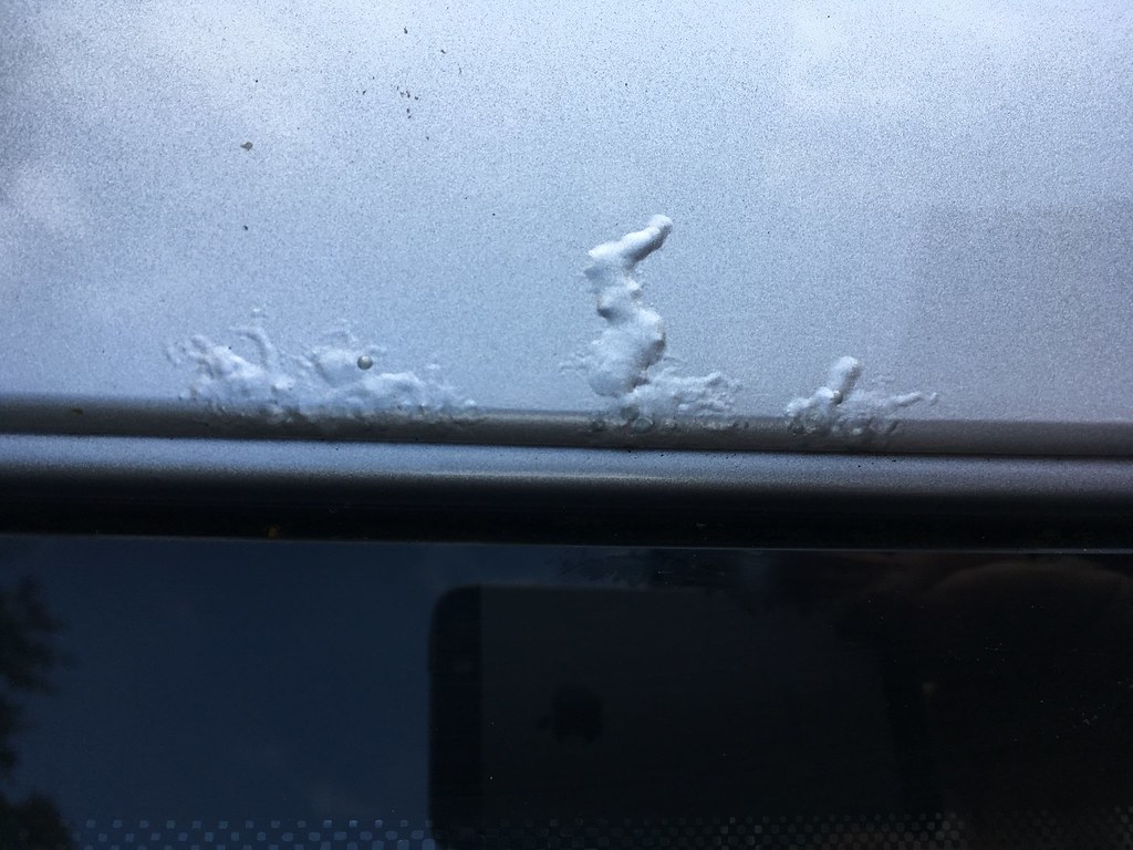

I wonder whether it's worth people posting pictures of their roof corrosion on this forum so one of us can download them in a weeks time and email them to watchdog?
A clutch of (literally) rotten pictures might add to the impact of the text applications we're making.
I'd be happy to download them and send the email. What do you think?

Looking at these images they are appalling. How can VW argue about this?
The loss of the original list is (IMO) a lie designed to wriggle out of their responsibilities.
